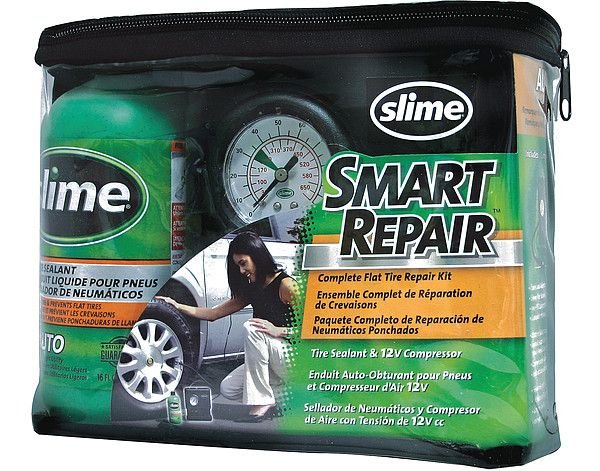

Your last comment there is a great point. Not the "never get a flat" part , but the importance of having a small compressor. Even with a spare, I will always have one of the small 12V compressors in the car. If you have a slow leak, like a nail in the tread, you can frequently pump it up enough to get to the tire store and get it patched or replaced.
My ex-wife still to this day calls me with car questions, even though she now lives 3 states away. She has a Justa Cooper convertible with no spare. Years ago, when she was still a wife, and not an ex-wife, I put one of these in her car.
So, a few weeks ago she calls me and says she came out of work to find a rear tire flat. I was able to walk her through using the compressor in the kit to get it up to 35 lbs pressure. After 10 minutes, it had not lost any measurable PSI, so I told her to drive to the nearest Discount Tire, which I had googled while waiting for the compressor. They were able to repair the tire (nail almost dead center in the tread) and send her on her way in less than 15 minutes. And, to be clear, she never had to use the Slime liquid, which I would consider a last resort.
Point is, spare or no spare, every car of mine has a compressor hidden away somewhere.

BMW straight up sold their z3 M's with no spare tire at all, and instead included a bmw branded compressor and bottle of slime. Not gonna lie, that compressor changed my life, and I run a small slime (go for the slightly more expensive $30 one, they tend to last longer) compressor in every single one of my vehicles, even my touring bike. Not only do they keep you going on a slow leak, but you can also air up all kinds of stuff, they're useful off road for airing down and up your tires (at least until I get a tire inflation system for my land rover) and you can even rescue other motorists with a puncture without having to change their tire.
I'm leery of slime, it can unbalance wheels slightly and is a righteous annoyance to clean off of the rim, so for a slow leak, I'd rather fill it with air and limp to the tire shop (they'll certainly thank you for doing so) but in a pinch where you're isolated in the middle of nowhere, it can be useful.
