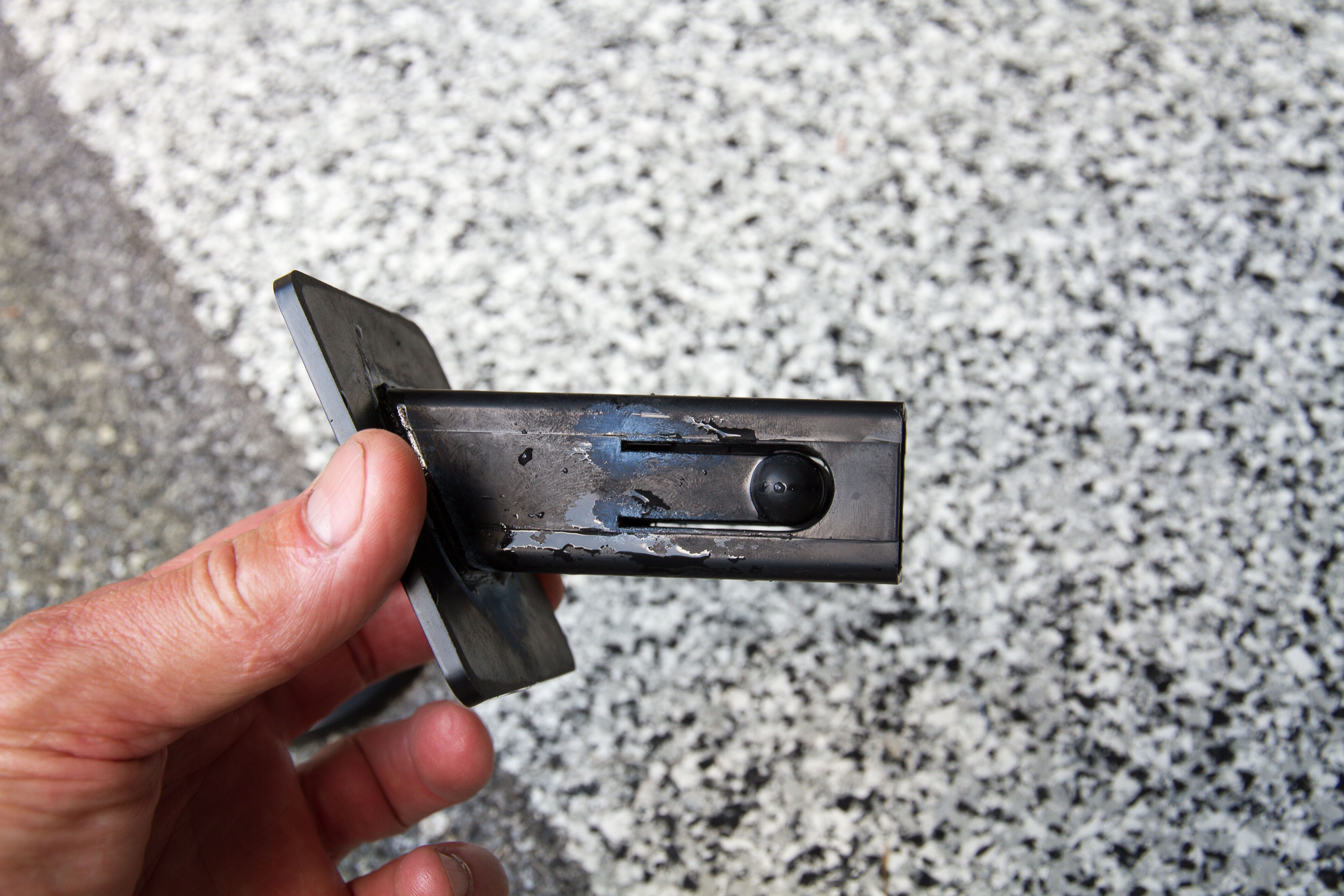

Here are my install notes:
Install notes:
Hitch
1. The lights on the bumper are easily removable. They should be removed and the wires unplugged as a first step. That way, the bumper cover won’t dangle by wires when it’s removed. Makes it much easier to reinstall cover too.
2. Directions say to torque bumper bar to 17 ft-lbs. That seems very low. I don’t have a reference, but I think 35 is more in line for such large bolts.
3. The back of the receiver tube needs to be cut ¾” on order to clear the muffler on the All4. (Per our discussion).
4. The directions should list needing a 18mm deep well socket for the bumper beam.
5. The torx size required is T-25 (not 20).
Wires
1. Black with white stripe on car = left turn = yellow on module
2. Yellow with black on car = brake = red on module
3. White with grey on car = tail lights = brown on module (see note below)
4. Blue with grey stripe on car = right turn = green on module
5. Directions say to connect power wire to cig lighter. Cig lights is very thin wire (gage 18 or 20). Power wire is 10 or 12 gage. Very bad idea to connect thick wire to thin. I used a red and yellow thick wire that is powered by the key. Kit should supply a 10-12 gage quick splice. I had to buy one at a car parts place.
Note: Car has upper tail lights in doors and lower tail lights in bumper. The lower ones double as brake lights (same bulb). Therefore, you need to tap into the upper tail light wiring (i.e. the white with grey stripe wires). I initially tapped into the lower ones and the applying the brake activated the blinkers and the brake lights on the trailer.
Also, I made my own hitch plug, which I think is slick as goose poo (whereas the one supplied with the kit is just goose poo! - everything else in the kit is good quality).
I bought it here:
http://www.ebay.com/itm/330942881765?_trksid=p2060353.m2749.l2649&ssPageName=STRK%3AMEBIDX%3AIT
I cut it at 27 degrees and glued it with super glue. It looks and works like OEM. I attached some shots. (Note: That's water on the plug stem in the 1st photo. I wasn't that sloppy with the super glue in case you're wondering.)
Attached Thumbnails 2016 Clubman-img_8059-2.jpg   2016 Clubman-img_8055r.jpg   2016 Clubman-img_8056r.jpg   2016 Clubman-028.jpg

Done! I did get the OutMotoring trailer hitch receiver mounted and a system worked out to keep a functional smart opener for the rear doors. Here's the story:
First, this is *not* a project for the faint of heart. I'm no auto mechanic, but I do have pretty good Fix-It Guy cred. It turns out that the mounted hitch geography allows for placement of the smart door sensors in pretty much the same position as before, but not with the original sensor mount. There are two sensors, which you can see below, and a control unit that all have to be in place. I started by taking everything off of the original mount and trying, with some input from my wife, since two heads are definitely better than one, to figure a way to mount the components on the hitch, but the relative positions of the sensors has to be just right. I could rig up a temporary way to do that, but there was no way to make that permanent. I decided to go back to the original mount and make it fit on the hitch, which took some serious mods. Here is the mount:
https://www.northamericanmotoring.co...attach/jpg.gif
Here is the modification -- removing the ends and also the control module tray, which I saved to provide a cushion for mounting the module to the hitch.
https://www.northamericanmotoring.co...1&d=1472234158
Once I got the idea that I could slightly deform the upper, flat sensor a bit, I mounted the new unit to the hitch receiver around the draw bar tube. Here is what it looks like, before I gave the cable ties a haircut. The flat sensor is above, the round one, looking like an antenna, is below, and the control module is on top.
Much to my delight and amazement, it turns out that this arrangement actually works.
A couple more comments: OutMotoring suggests removing foam spacers from the bumper mount, which they say allows the bumper to fit better over the hitch receiver. I did not find this to be necessary, so I left them in place. Also, their instructions have you removing, quoting from their instructions, "ten (7) 8mm screws from the bottom edge of the bumper." There are actually 8 of these screws on mine. Next, they call for cutting a slot in the heat shield to make it possible to reach up and secure the drawbar, but, possibly because we have the smart opener, the heat shield is formed differently and doesn't interfere with the new hitch. I did end up having the heat shield an inch away from the two bumper mounting screws in the center , so I could only replace 6 screws, but the mount is still totally secure. I may go ahead and attach these with flat metal bridges. Finally, given the shape of the lower bumper trim, it doesn't look possible to get the plastic plug, which hides the hitch receiver when not in use, to fit totally flat. I'll work on that, but I may try JohnnyQuest's suggestion, earlier in this thread, for a hitch cover.
If you plan to try this install, I'm happy to answer questions. I was at this for a week in my spare time, but most of that was spent trying to imagine how it could possibly fit! Have courage.
