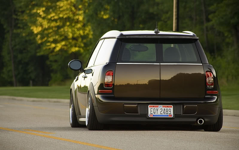

Reflector delete was a plastic-weld, sand, paint project.
You are correct on the plug source.

Originally Posted by Black11mccs
Rally, those plug faces look kind of thick; are they? or did they feather/blend in nicely with the paint? also, with the rubber gasket, when you screwed them on did they compress out and around the edges of the plug? one last question, where did you source them from?
Mine were quite thin. Not bulky at all so they go on nice and smooth.
I forget where the actual source was. Sorry.
You can see how thin they are here:

Originally Posted by grueinthebox
Was afraid of that, but car's not here yet to have checked in person. Will have to keep my eyes peeled for a good deal on some rear trim. Was already wanting to see what I could do about extending the beltline molding across the rear trim anyway - with the black/silver trim that's coming on my car it looks a little "off" that there's that break in the beltline.
This is what you're working with once the reflectors are removed

Rally,
im driving my self crazy trying to find the plugs you used....If and when i do find them which side did you place the rubber washer (i assume outside) inside couldn't work because it wouldn't seal the water out.....right?
on your pics it looks as if you the washer is on the inside? if so do you have problems with water coming in?
Old Jan 11, 2011 | 01:35 PM
  #87
Rally@StanceDesign's Avatar
Rally@StanceDesign
Joined: Jan 2004
Posts: 8,337
From: oh10
Rally,
I used it on the inside. Why wouldn't that work? It closes any gap that water would come in. It's a specialty washer specifically designed for this purpose. As the nut is tightened, the washer compresses and seals any of the gap keeping water out.
Has worked for me thus far.
