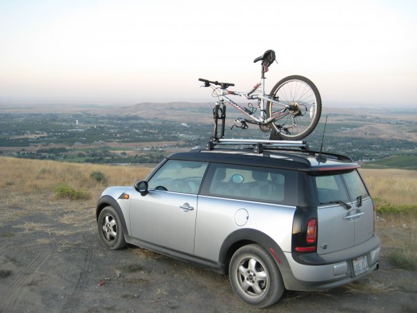

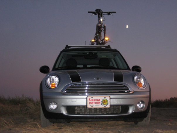

And here are some photos from my first ride.
Had a little bit of trouble attaching the "front" part of the Racing Cycle Holder to the Cross Bars. Took me a while to get the allen wrench to engage the bolt & loosen the tab (the thing which goes inside the Cross Bar). I thought it was broke. It was hard to see what was going on---you stick your allen wrench tool in there and then loosen it up---just took me a while to figure out how to loosen it up.
After that, it was pretty cake getting everything set up---Love it so far!
