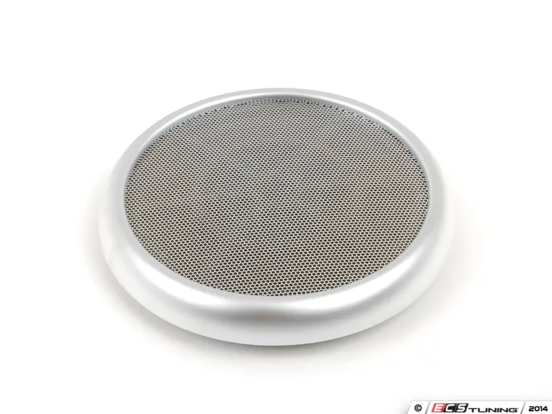

The lower h/K door speakers can go, they tend to rust on terminals from moisture with age. Linked above. Also the rear speaker covers on the convertible fall apart. I replaced both the lower speakers in the door with H/K new ones, used ones will most likely be rusted or bad at the terminals. The speaker covers on the back used a pretty bad also. The foam fabric falls out and the grille falls out and rattles which is annoying.
https://www.ecstuning.com/Search/Sit...h/51437132691/

The speaker covers on the back used a pretty bad also. the foam fabric falls out and the grille falls out an rattles which is annoying
+1 and +1
After completing the recent upgrades on my daughter's R52S (adding noise mat under the rear seat and in the trunk, and lining the rear speaker cavities to seal them, too) I am pretty impressed at how well the H-K system sounds. We also added a JBL BassPro Go for a little more bass (and it can be undocked to use as a bluetooth speaker at tailgates, picnics, etc.).
While I had the interior panels out, I did clean away all the rotted foam from the rear speaker grills, and then I hot-melt glued the mesh to the grilles again to stop the rattling.
