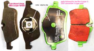

I was doing a brake job on my wife's car, the first 'out of warranty" service, and when my new pads arrived they were too big to fit.
After a quick call, I was informed that our 2007 Mini Cooper S convertible was fitted with "standard" brakes rather than the "S" brake calipers and much larger pads (that we thought we were getting, and paid for).
Since the swept area of the pads certainly influences braking performance, it seems that BMW/Mini eagerly sold us the heavier convertible "S" car with a supercharger for a lot more performance than the normal Mini but with the substandard (for the extra weight of the convertible and performance of the supercharged engine) non-S brakes.
This seems wrong.
Has anyone else had this happen?
Is this the usual equipment for the "S" convertible?
Are there any remedies?

The '07 and '08 convertables were still super charged. The "S" models came standard with regular brakes. The option for those years was the JCW brakes which is the same as '07 and up "S" brakes on turbo charged cars except for the color. JCW brakes are red and the '07 and up "S" brakes were silver. A lot of people find the '07 "S" brakes as take offs in the market place and install them on the supercharged cars.

Nothing confusing here....you have a stock gen1 cabrio.....and it sounds like you ordered/were shipped the wrong part.
Like previouly said, many folks added gen2 brakes, which are gen1 jcw brakes/rotors minus the red paint+stickers.

p.s. a qwik visual check for anyone wondering. GEN1 disk brakes (non JCW) have a spring clip on the outside that holds the two halves of the caliber together (vibration control I've read). This clip is a minor PIA to get back on when the time comes.
'clip' in this picture from MiniMania site
GEN2 brakes do NOT have this spring clip on the outside. You can see this clip thru most wheels.
OP's picture is a perfect shot of the difference between GEN1 and 2 front pads - note size, shape of the end lugs, and the spring clips on the inner front pad. On a GEN1 inner rear pad you'd see the spring clips to grab the outside of the rear piston. GEN2 pads are smooth on the back side.
