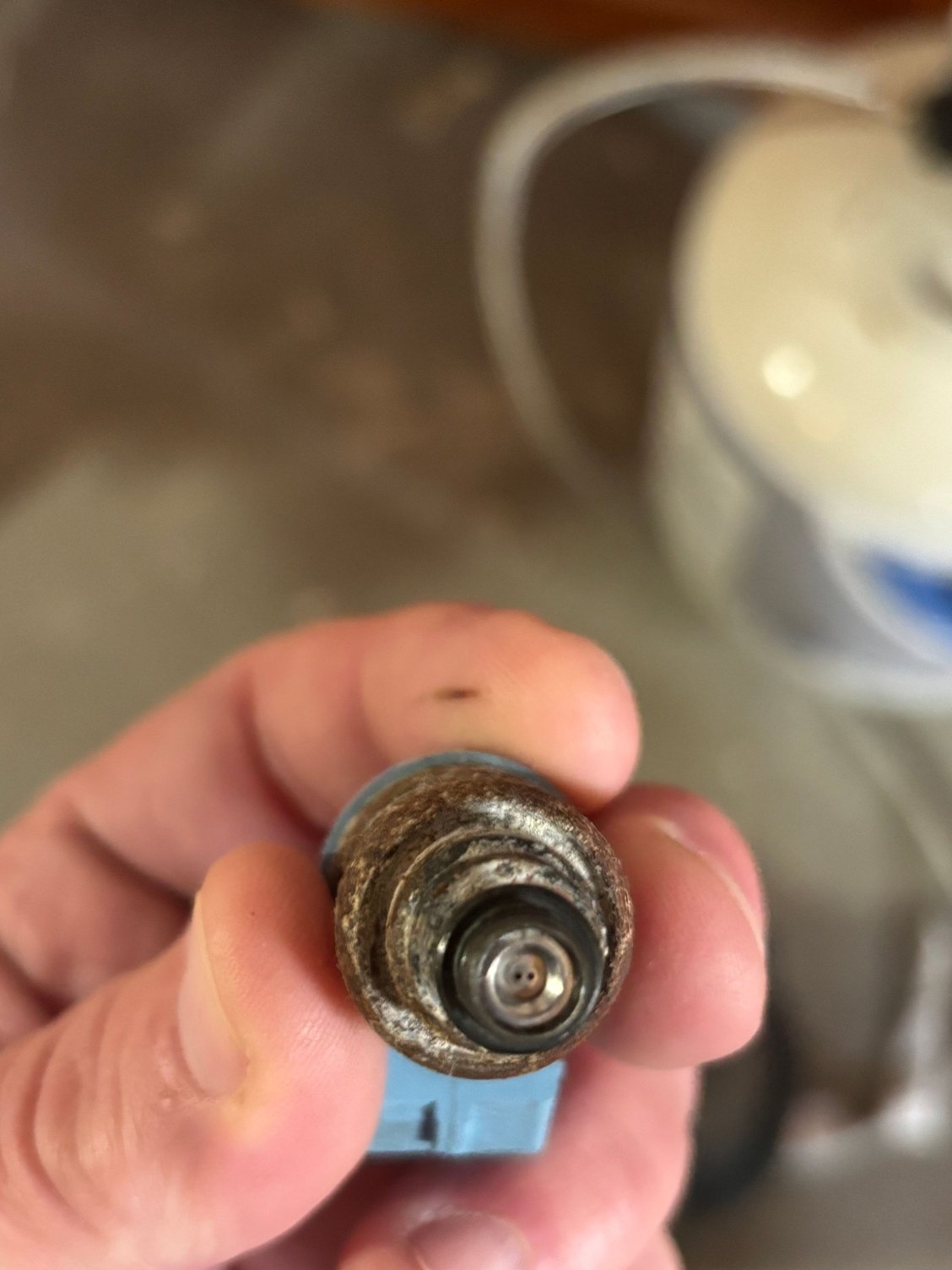

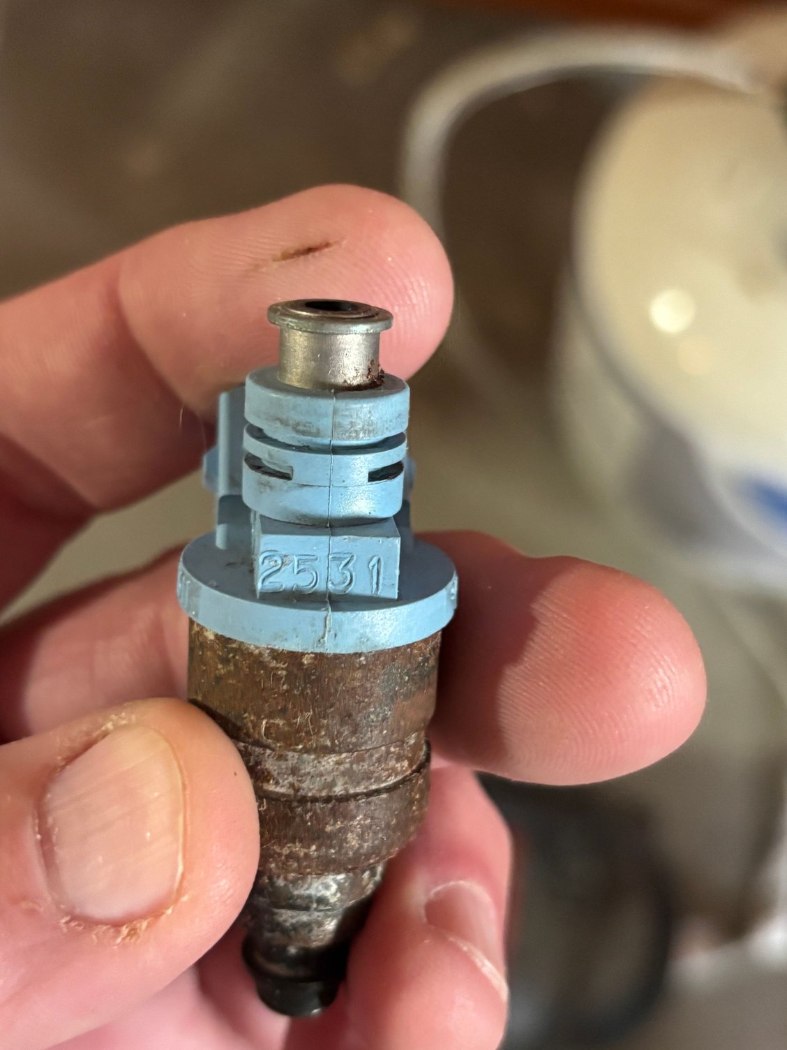

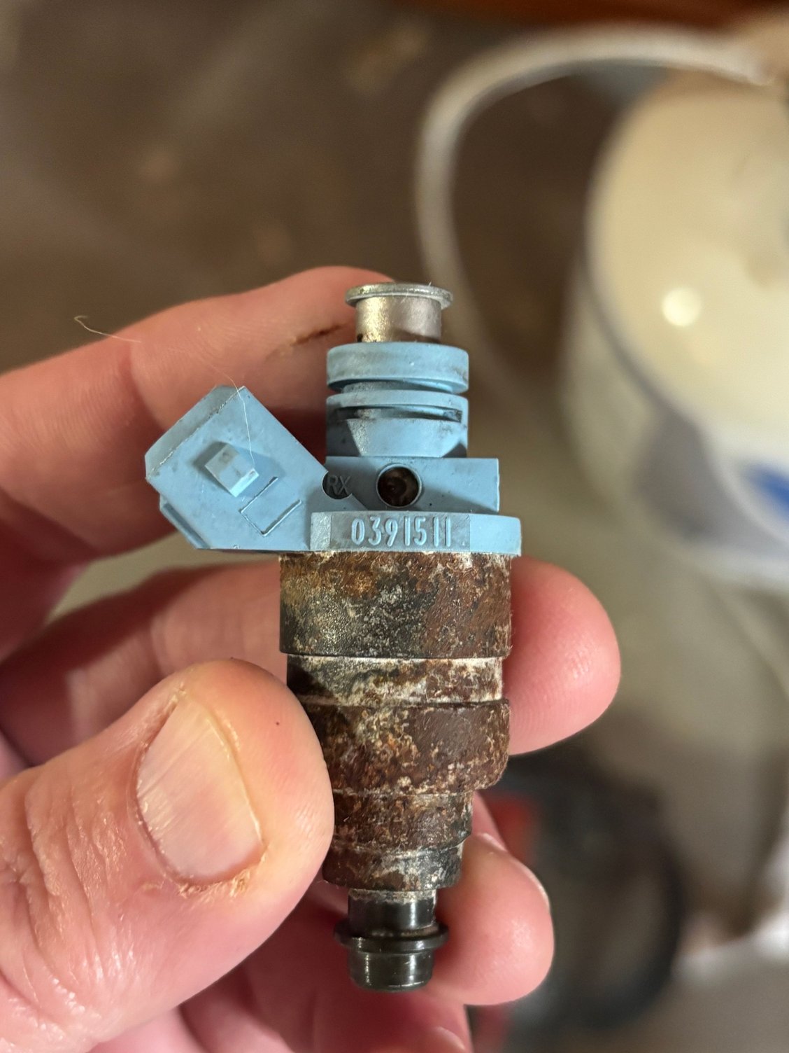

I was talking with Adrian the tuner guy last week about tuning my car and I had to convince him my OG JCW injectors weren’t knock offs because he said real had 4 nozzle and fake had 2. I think there may be either a change along the way or just confusion. I’m new back in the mini game. I saw the pics on waymotorworks and others show 2 nozzle as well. Here are my for sure real and rusty JCW injectors. (I bought an eBay injector cleaner and flow tester for like $90 just since they’re old and I can show diff between these and R53 injectors when I pull them)

I can also confirm with you -The genuine Seimens/JCW 380cc injectors have 2 nozzles. Not 4.

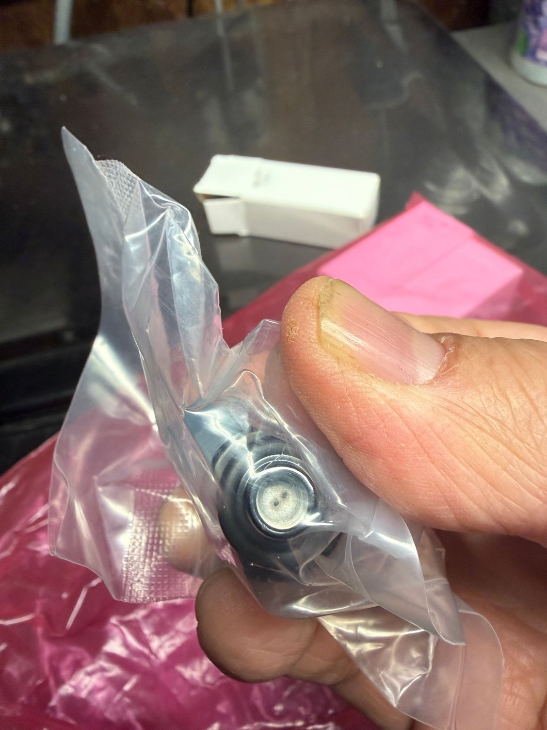

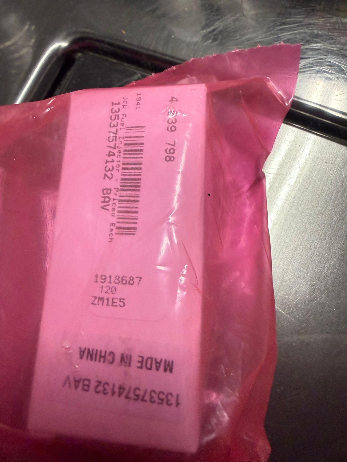

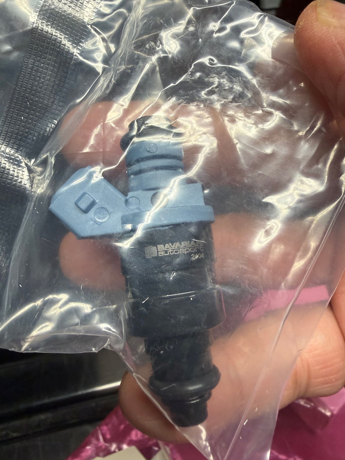

These are what I got from that ECS link - old Bav Autosport.
These are 2 hole - yes made in China.

They’ve got pretty bad reviews overall, which are generally poor, with many users reporting them as unreliable, inconsistent, and potentially "cheap Chinese knockoffs" causing misfires, poor fuel trims, and severe, sometimes unfixable, running issues. While some users report success, most recommend avoiding them.

Chinese **** mate, send them back, not good.
