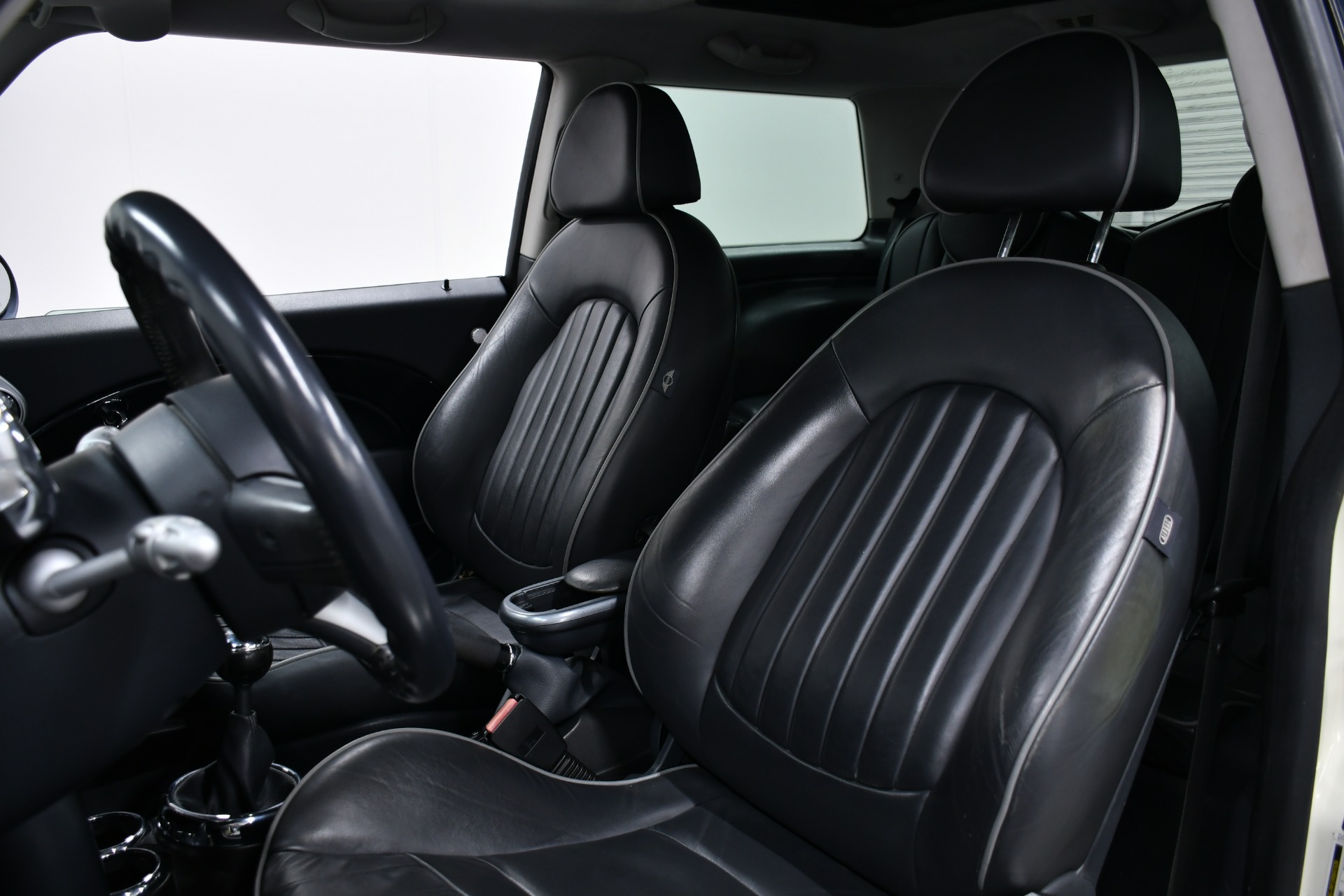

when i was looking at seats for mine, i found that the leatherette seats and the leather seats have different designs. and genuine leather was not a common option. i ended up with r56 seats.
these are leather.
