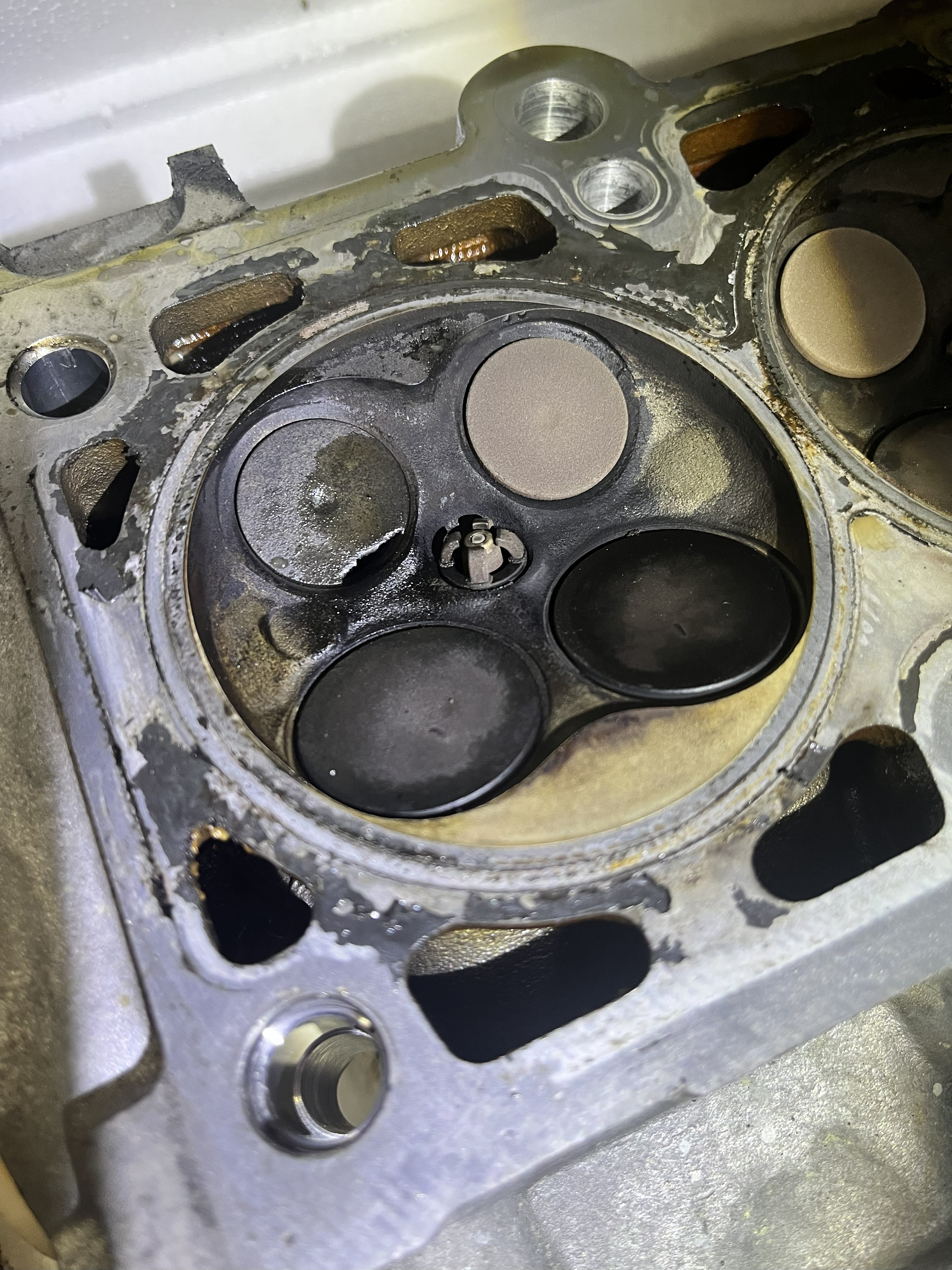

Old Nov 29, 2025 | 07:38 PM
gratefulone's Avatar
gratefulone
Joined: Oct 2020
Posts: 26
Likes: 9
They all looked good. The marks on the cam wiped off. I'll check again tomorrow in the day light. Just pulled the head. Looks like one of the cylinder 4 exhaust valves is partly gone. The bore and piston look okay.
