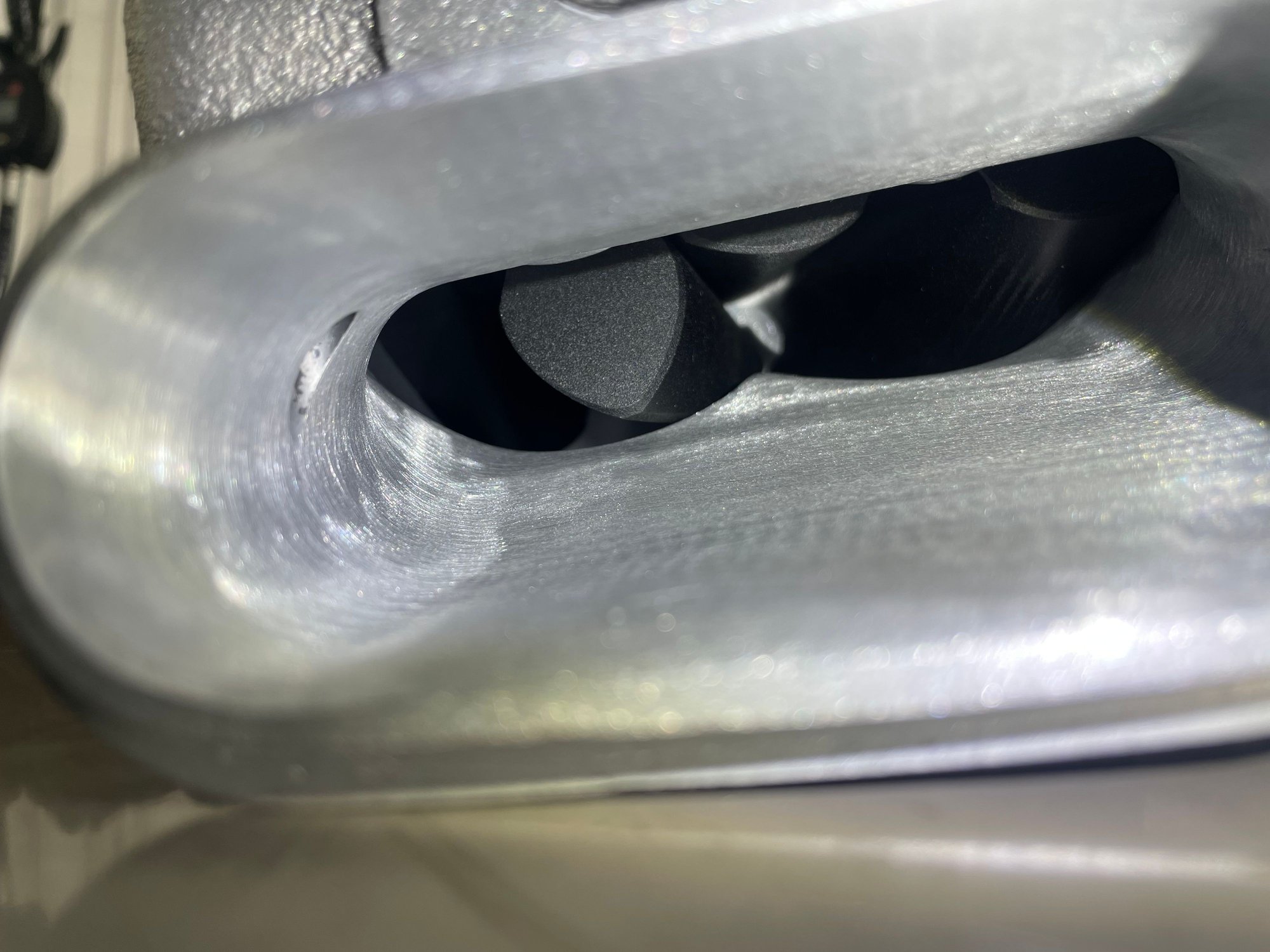

[QUOTE=GLEX;4705482]I spoke too soon... Another Detroit Tuned supercharger failed on me with less than 3K miles. My faith in any rebuilds is low at this point and the shop wants to put a new one on for $4500. I'm debating taking a chance and buying a local used unit for less than $500, with a reported 130K miles and rotors that look to be in great shape. With an oil service, maybe it'll buy me some time until there is a better option. What do you think: pay the BMW premium, gamble, or go for a TVS900?[/]
I cannot recommend Stiegemeier enough. I am thoroughly pleased with his work. My ported supercharger from him, with the grip texture on the pulley cost me less than $2000. I’m thinking it was around $1800.
Without the porting and textured pulley, it would be less.
This is the supercharger before I installed it:
His stamp on it:
The porting vs unported:
a closeup of the port work:
I am just a satisfied customer. Bob Stiegemeier did not ask me to talk him up and I have no affiliation with his business. His work speaks for itself.
Excellent, thanks for the testimonial and photos. What was the turn around time like on that rebuild?
His stamp on it:
that looks fantastic!
I ordered mine "off the shelf" from him. I received it in about a week, IIRC and then sent my supercharger core to him.
