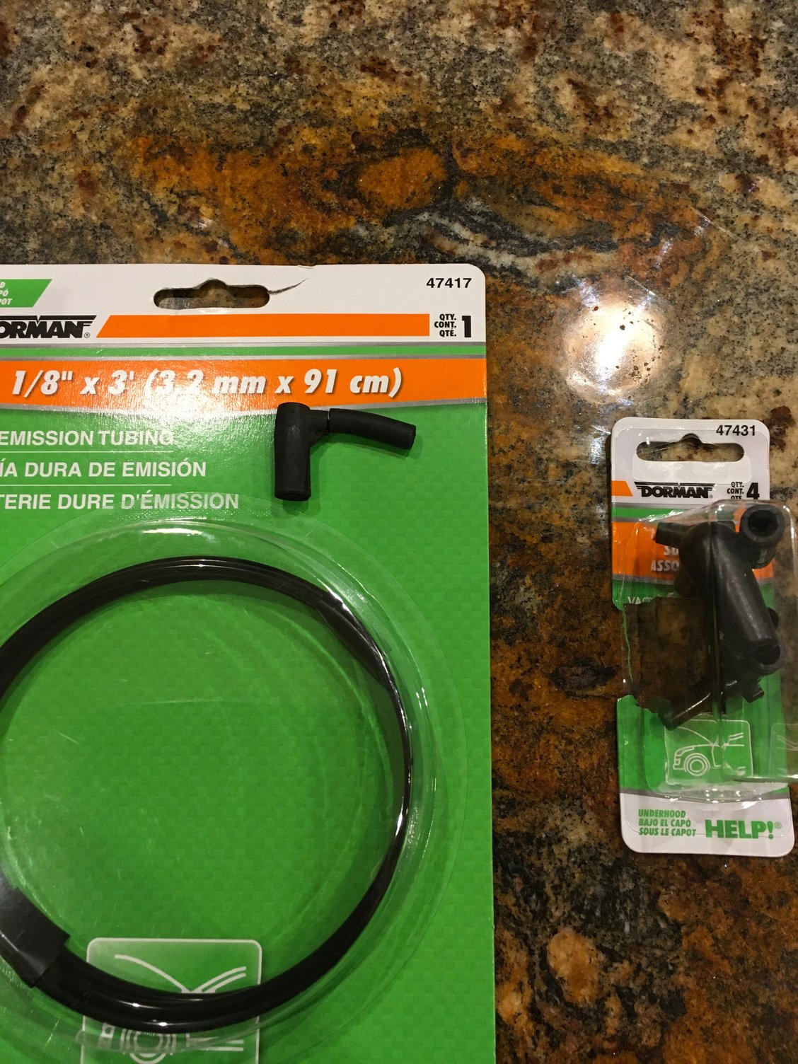

Old Feb 10, 2025 | 06:24 PM
Tombstone's Avatar
Tombstone
Joined: Sep 2017
Posts: 586
Likes: 97
From: So. Cal
Figured out the JCW Airbox flapper door elbows , Dorman sells a 4-piece kit utilizing 1/8” x 5/32nd elbows (41431); which took 2-packs and also replaced the 1/8” hard plastic lines (47417). Total cost was 2-kits @ $8 each for elbows & 1-kit @ $9 each for tubing versus the OEM 3-lines @ $55 each from Mini/BMW …
