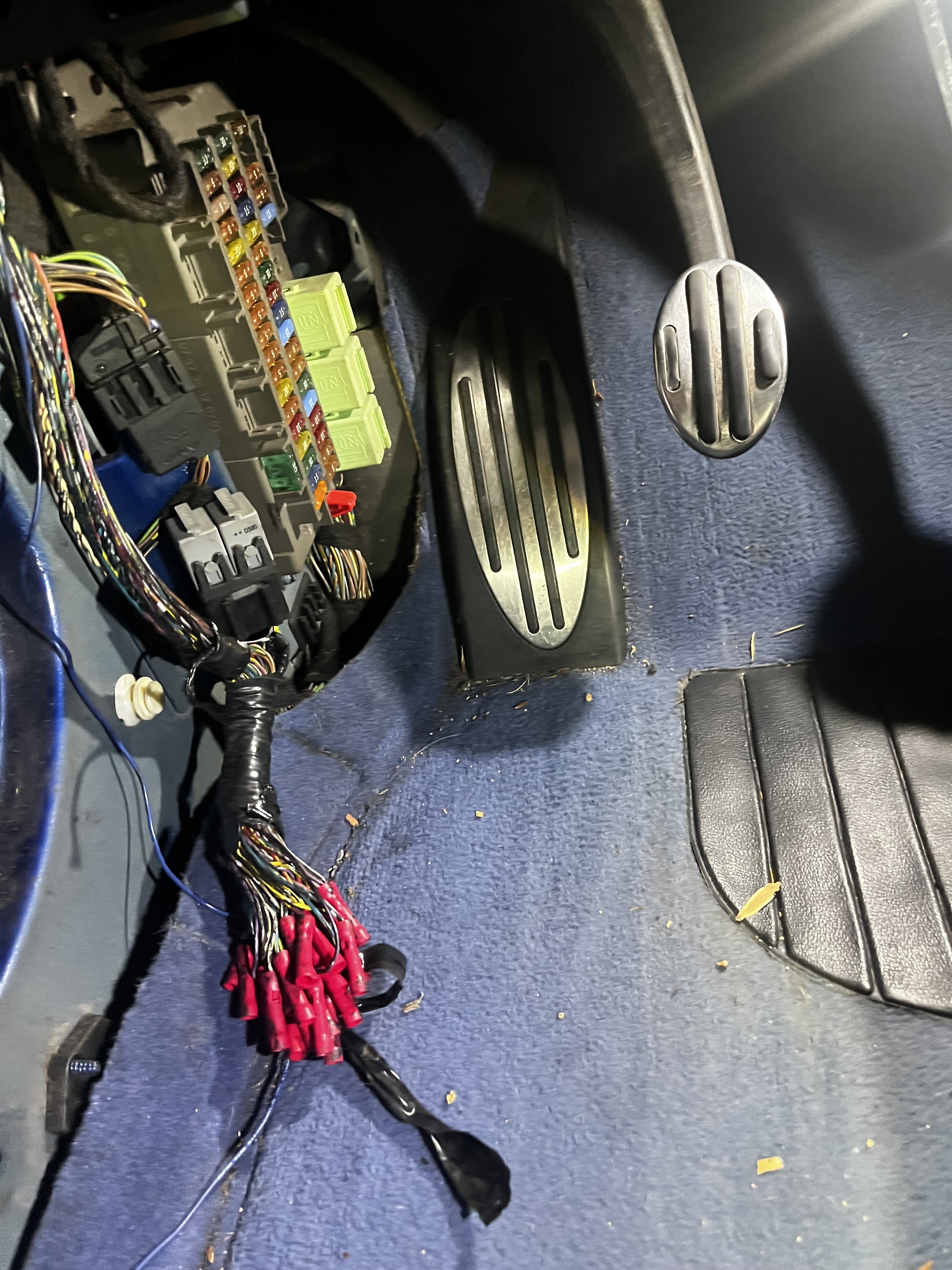

Backstory: 2003 R53. My airbag fault light never comes on. Not during start-up or self-test. Never. No codes for the airbag system are popping up on my scanner. I suspect something was cut, coded out, or covered up. If they were coded out, the light would still self-test I think, so I don't believe that is it. I pulled the instrument cluster, found electrical tape behind the airbag light, and removed it. Still no light. I checked pin 12 (airbag light wire) on the instrument cluster connector; it doesn't get power on start-up. The airbag fuse has power on both sides of it. I was working my way downstream when I pulled the driver's footwell panel and found this disaster. I assume someone cut a large pin connector out (likely due to moisture or corrosion) and crimped the wires back together with butt splices. I think I have a few issues here, and I need someone to confirm my thinking:
1.) Remove all the butt splices and replace them with solder sleeve connectors or reinstall a pin connector. It looks like that connector just attached the wires from the instrument cluster to the wires that go to the fuse panel.
2.) Continue to troubleshoot the airbag system. I'm thinking maybe the airbag control module (under the brake handle, I think?) is bad. All the connectors are connected under the seats. Perhaps the control module is completely disconnected? I don't understand why the light doesn't illuminate on the self-test unless the gauge cluster is faulty (I am unsure how to test that yet). Any further ideas on where to look would be helpful. I want the airbag system to work correctly.
3.) Send the BCM to ECUPros for testing. Everything in the car except for the clock and central locking works. Constant codes are:

Pointers or confirmation would be super helpful to get this thing sorted. When I bought it, I knew the car wasn't looked after very well, but I didn't want to see it end up in the dump, so here I am.

Sounds like a bad-or broken Clockspring when the steering angle sensor was replaced and the steering wheel was disturbed (not locked straight ) ? This would break the Clockspring, tripping the airbag light on dash and overhead light , which disables the airbag & horn.

I would think the Clockspring is functioning properly .Ohm out all the red crimp connectors first . Then remove all the butt splices and reinstall with pin connectors …

In case anyone ever runs into this, I figured it out. The car likely had a driver's door leak somewhere along the line, which I assumed damaged the 40-pin connector in the footwell. One of the PO's decided to cut it out and then rewire it incorrectly using cheap butt splices. I went wire by wire with the schematic, resoldering all of them. Now, everything works as it should.
