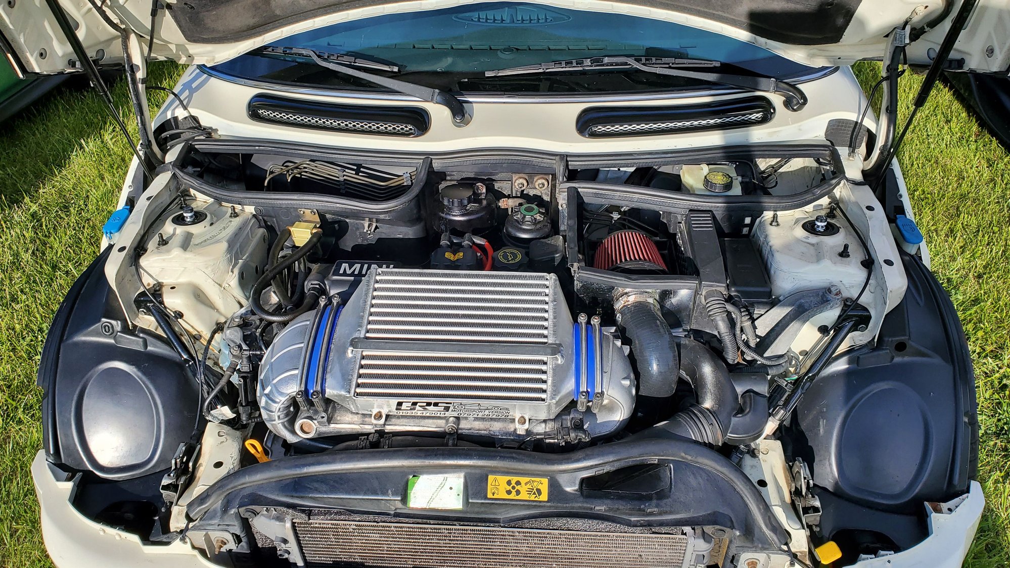

I will vouch for adriancl.. he's tuned BOTH my minis and all my local buddies minis too.. the guys amazing !
one of my minis is a full build . Head , cam , 21psi sprintex and methanol.. adriancl has it running PERFECT, afr are spot on... here's what I pulled last year on my lesser hp setup I was running ( should be abit quicker now )..
The ONLY tuning I'd pick performance adriancl would be on spot , dyno tune and road tune. BUT adriancl does live tuning and if you got the rite stuff you can have him tune your car , on the road and get it SPOT ON..
I've seen adriancl take a tuned car from a reputable ,popular vendor and make the car make 15hp and tq more than it did on its previously so called performance tune..he also corrected dead spots he found in it and showed the errors in the previous tune..
I highly HIGHLY suggest going with adriancl..
Btw , the 4.4sec 0-60mph is in my grey mini...but dont sleep on my white one , it too is pushing 19psi but less mods.
