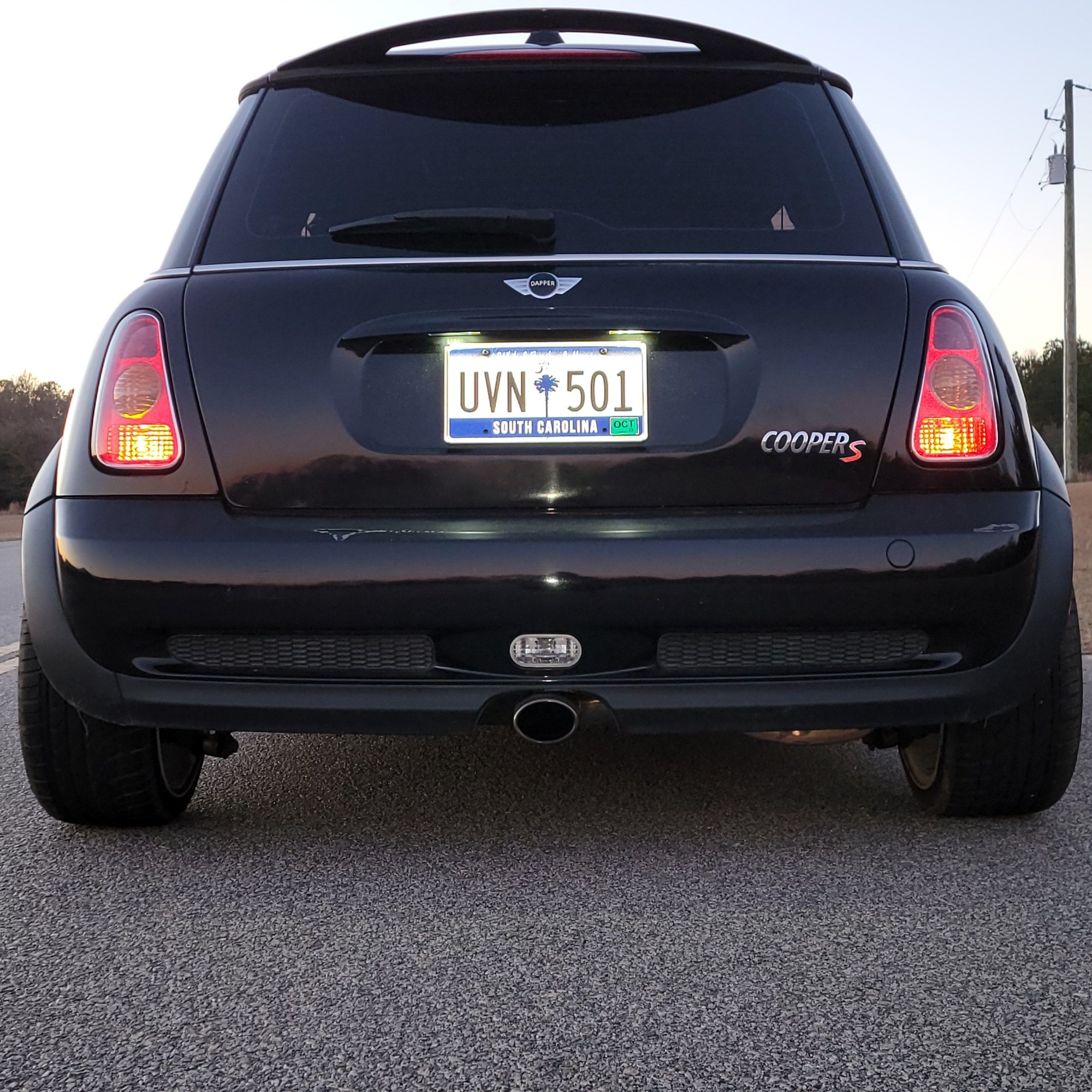

Most definitely pulling hard to the right. I drove the R53 to work and had to drive on a noticeably crowned road. Needless to say, I had to hold the steering wheel at the 11 o'clock position to keep it straight.
I've had the absolute worst luck with tires and alignments. Living in South Carolina AND the 18" wheels are a horrible mix.
Current rear end camber. Don't have pics of the thread at the moment. I would estimate well over 50% and wearing even.

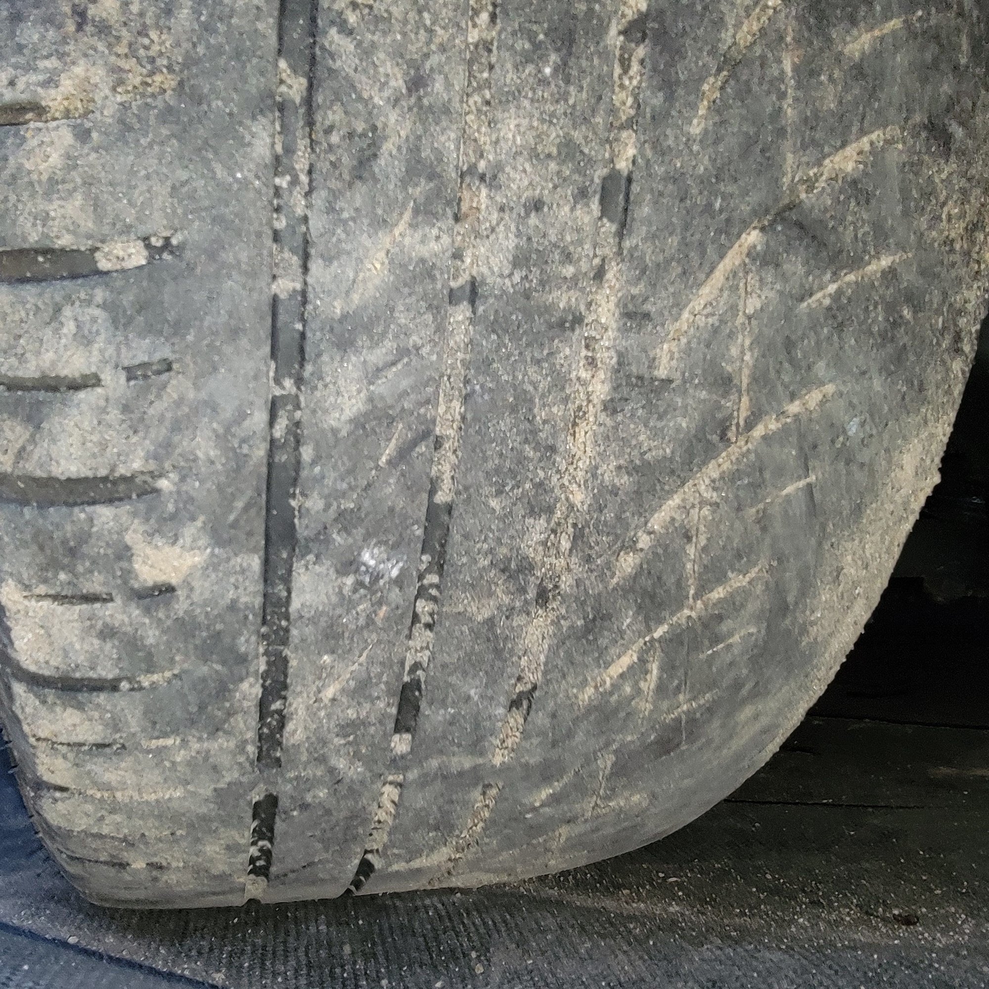

Front tires as they sit at the moment. Wow, baldness, and oh that highly uneven tread wear... It's a reoccurring issue. Since buying the car I've had front tire wear issues at ridiculous rates. Yet their camber is nowhere near as visible as the rear tires.
