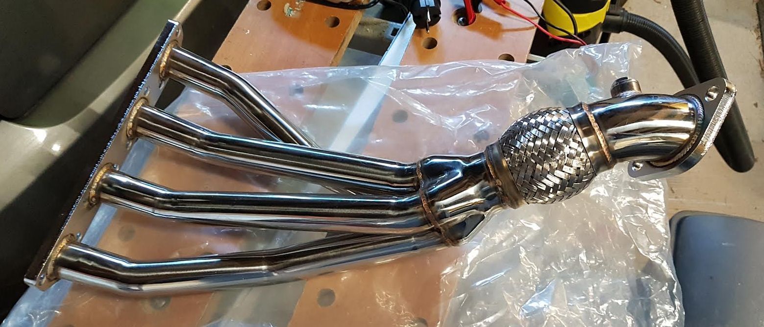

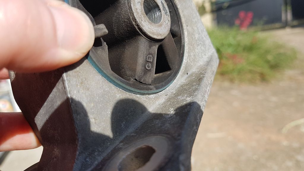

Hello,
some news from my Mini, I change:
- front suspension bushings (Powerflex) and ball joints
- front anti roll bar bushings (Powerflex)
- belt 6PK1368, I found somewhere on the net a calculator for the right belt length according to the pulleys, hopefully it was the same length
- crank pulley (OEM)
- header and catalytic converter (Malian)
I dismount all the front sub assembly to change the ball joints and bushings.
the next step will be the front braking system, I will upgrade to the R56 rotors, calipers and pipes.
