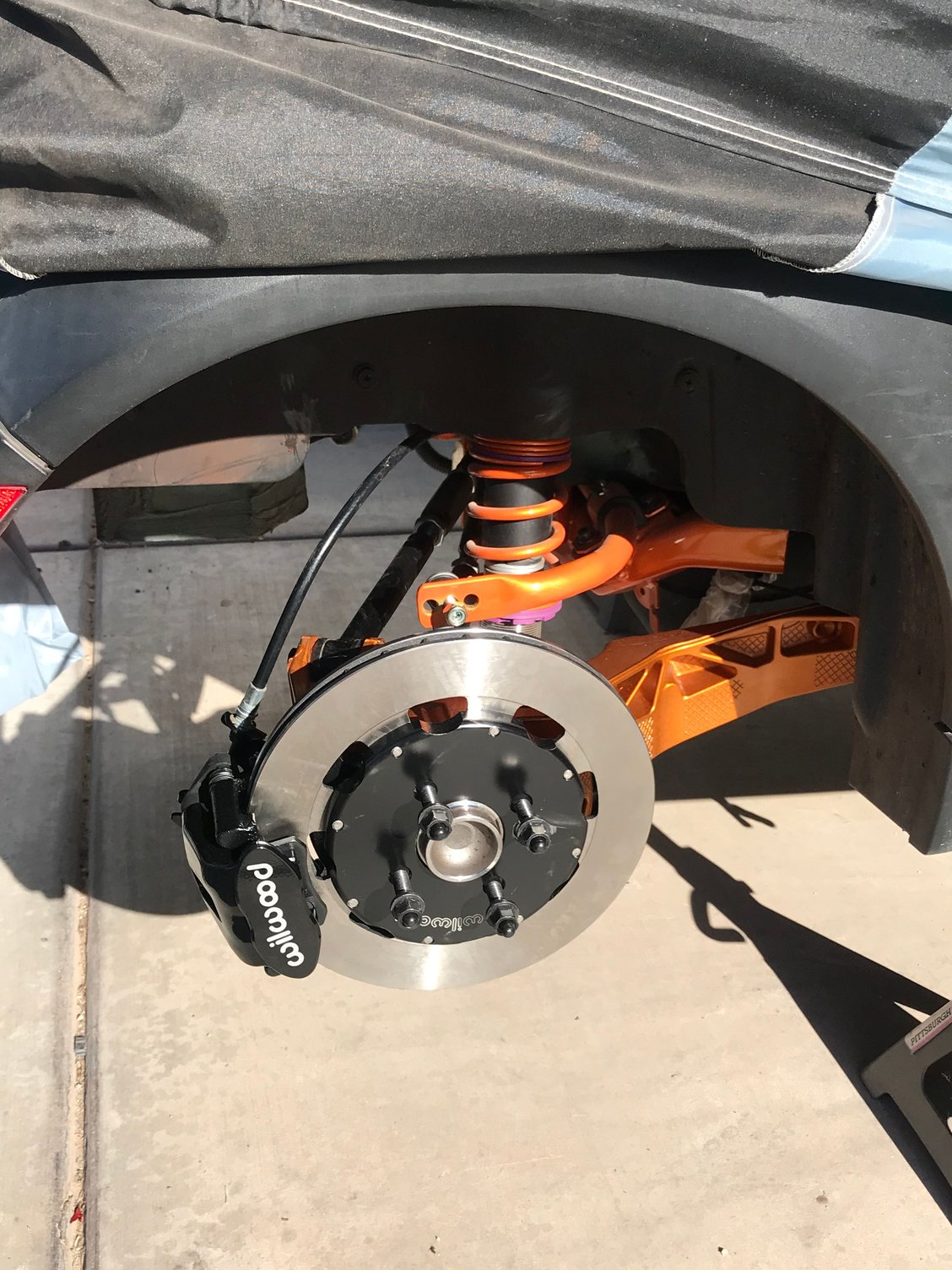

I ordered my kit from Way, he supplies everything needed. Last photo is me taking the bottom coil over off after forgetting the to put the adapter on 😵‍💫

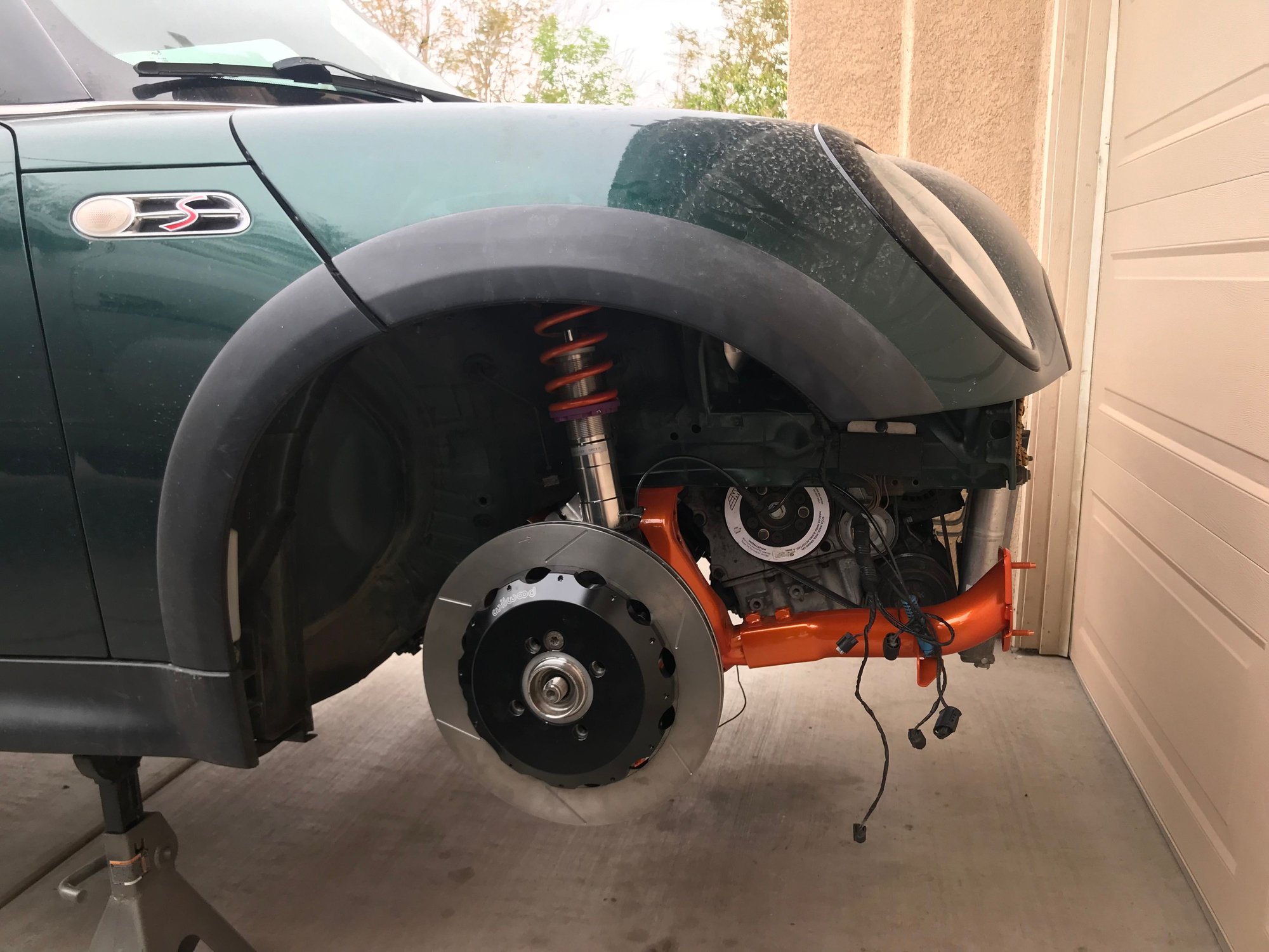

Originally Posted by jjcsnlynn
are those 2 piece rotors? Where did you get them?
yes, they are the Wilwood rear brake kit. Nice kit that allows you to retain the e-brake.
here’s the front if interested

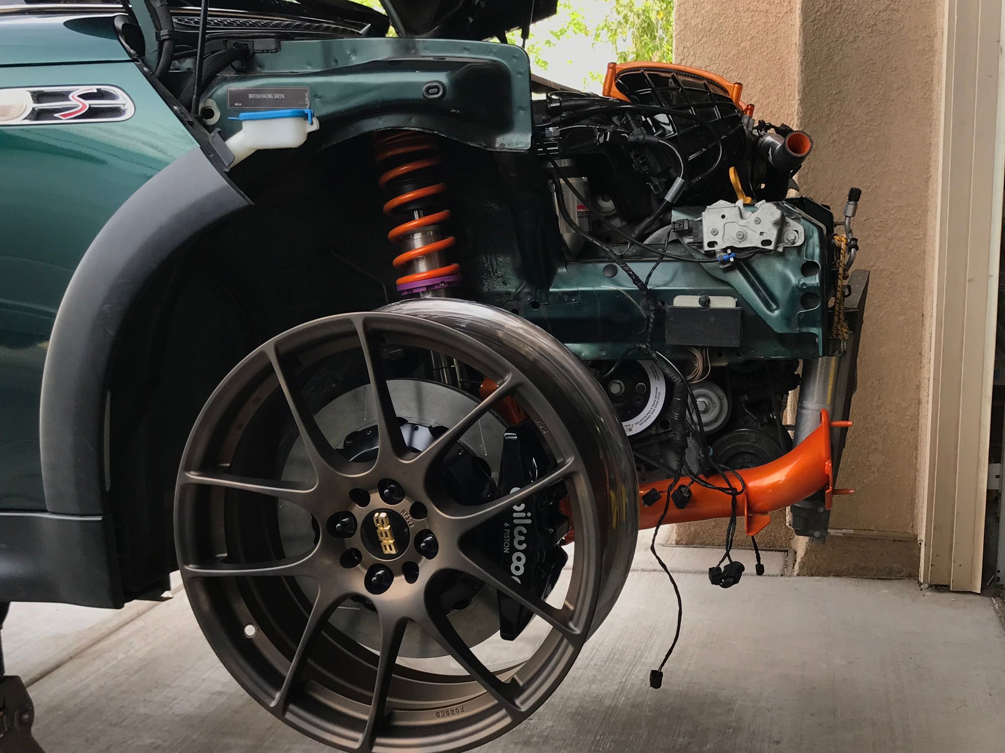

I second the purchase from Way. I did the same and everything was pretty simple. Don't forget the power flex bushes for the front pivot. For nicer looks you may want to purchase new control arm and lower shock mount bolts. I ceracoated everything, added new hubs, new control arms and new brakes. I hate having old bolts having out back there.

Very nice set-up ; what coilovers are you running?

BBS wheel size?
What size are your BBS wheels?

18 inch forged

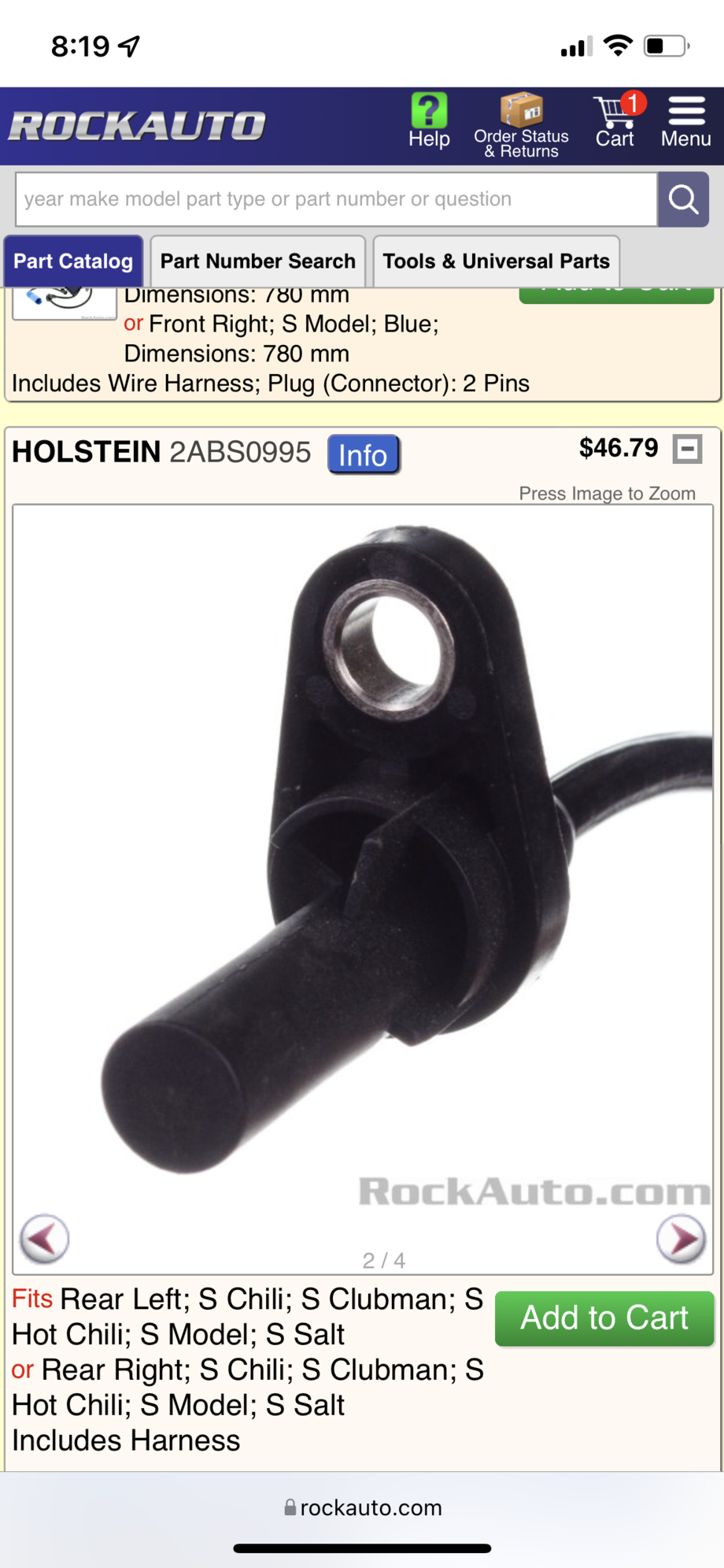

Originally Posted by shrevemini
I did a little further reading on this. There have been issues using the R56 sensors. They switched back to the R53 sensors an fixed the issue. Will swap around tomorrow.
That is odd. I remember them being different lengths and I believe different diameters.
I had a ABS issue right after my conversation and had to order a new R56 rear sensor because it would fit an R53. My issue turned out to be an ABS module in the end.

Originally Posted by Tombstone
Is the R56 wheel sensor you used was new or used?
I installed used trailing arms and then installed a new one during troubleshooting.
Rockauto has them different part numbers.
