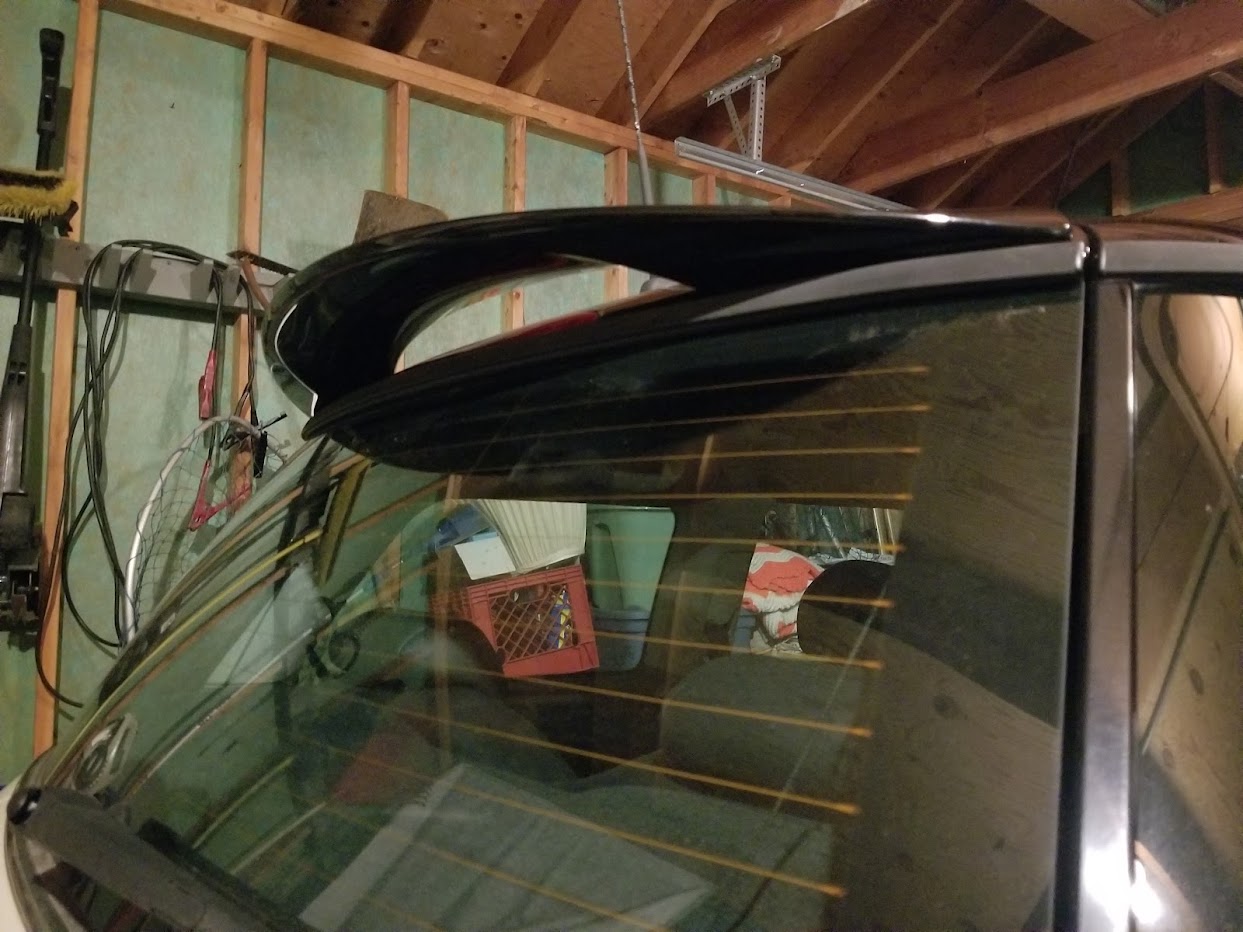

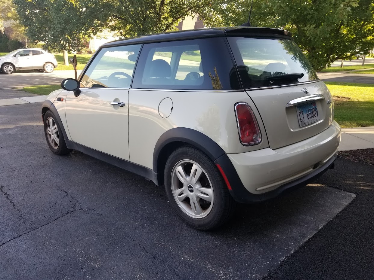

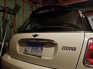

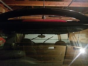

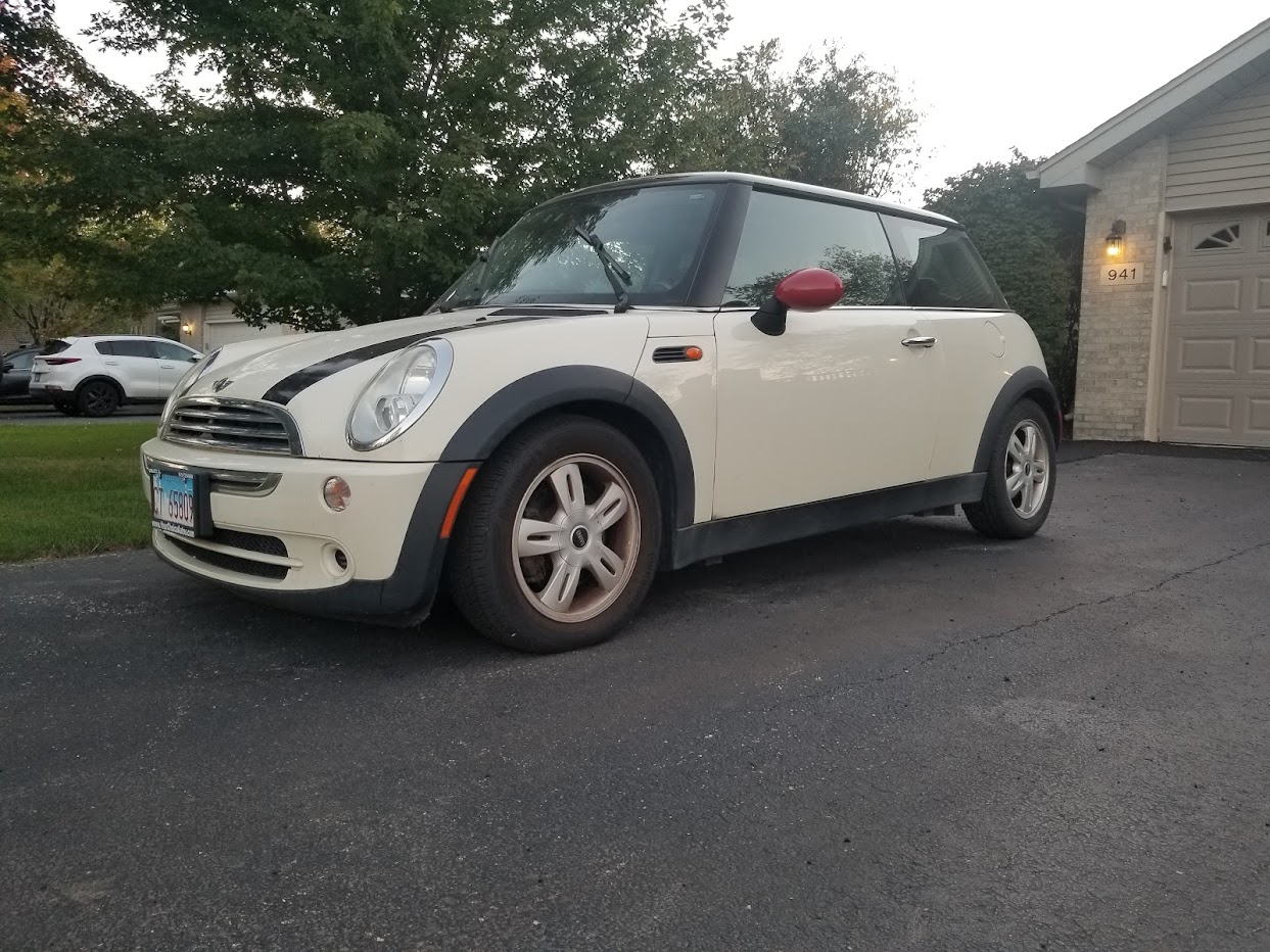

Hello all.
So I am thrilled to own an R50 in Pepper White. She's got 111k on the odometer and could use a bit of cosmetic upkeep, but she's a strong runner and I have some neat plans for her. I started by replacing the black wing mirror caps with Chili Red ones. And have just installed a factory black R53 rear spoiler.
About a month ago the passenger side sunroof drain tube worked loose causing some inside flooding in the pass footwell and a water soaked roof. The headliner started falling down so I pulled it out and replaced the fabric myself. I decided to change the color of the headliner from grey to black. I sourced all new sun visors and reading/map lights in Panther Black. Shortly, I will be adding black grab handles as well. Such a neat look.
Next plans will be to switch out the Anthracite door card trim and dash trim to Chili Red for a little color contrast. I'll post some photo updates accordingly.
Cheers.
