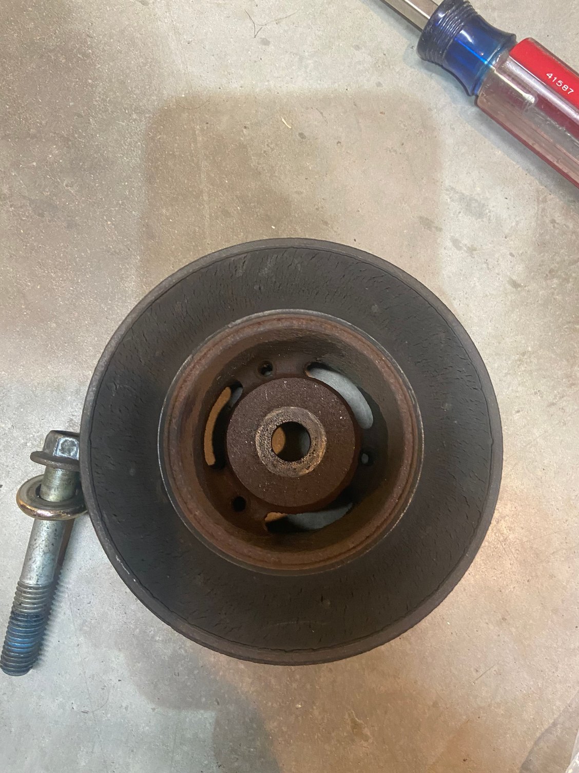

Well after much trepidation and no return call from the local mini shop, I decided to sack up and go for it. I squirted some WD-40 on the bolts and in the crank pulley and pulled the pulley off. No drama at all. The scary parts of the job were:
1. removing the crank pulley bolt, it took more hits from my electric impact than I thought it would before it broke loose.
2. Pulling the ati pulley back on, it took more torque to get it moving on, and keep it moving.
3. The first start, just making sure the belt alignment was right.
overall not as bad as I thought it would be, and now I can enjoy the benefits of the ati damper.
The old pulley didn’t look terrible. I originally thought it was the original pulley for the car, but judging by the blue lock tite on the crank bolt, I think it had been replaced at some point. The previous owner of this car also replaced the lower control arm bushings with oem rubber bushings rather than polyurethane bushings so they made some interesting choices.

Thanks! I honestly was surprised that it went so well, and my original pulley honestly looks ok, which made it harder to justify pulling off a perfectly functioning pulley, but this way I shouldn’t ever have problems with the crank pulley.
