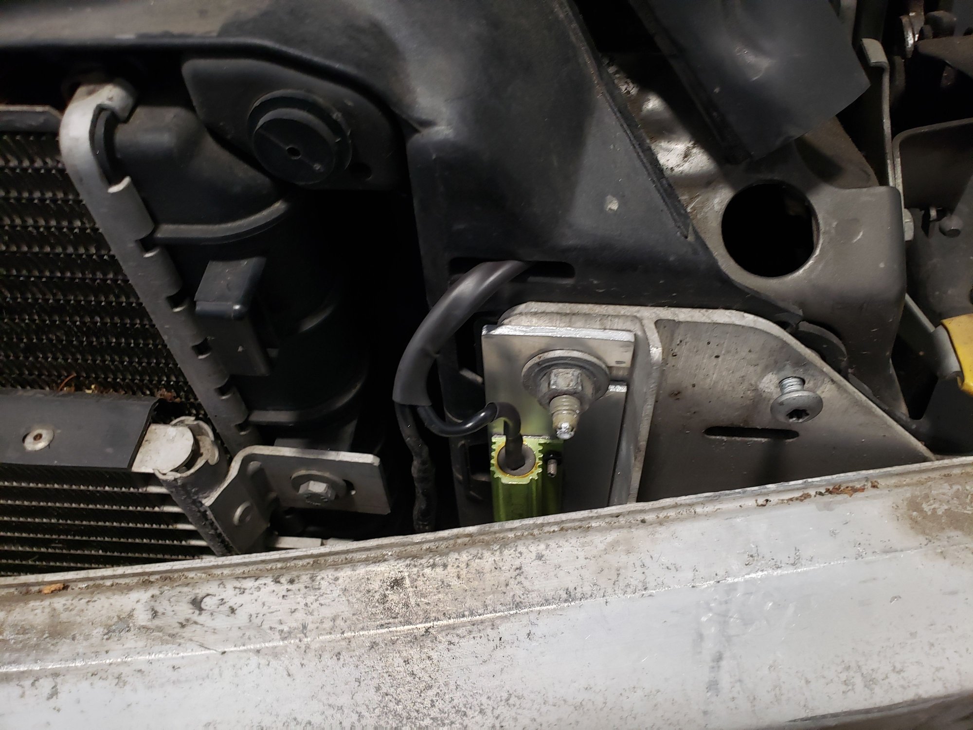

Also, fixed the low speed fan. Mounted a resistor to the crash bar using aluminum plate affixed with existing nuts.
