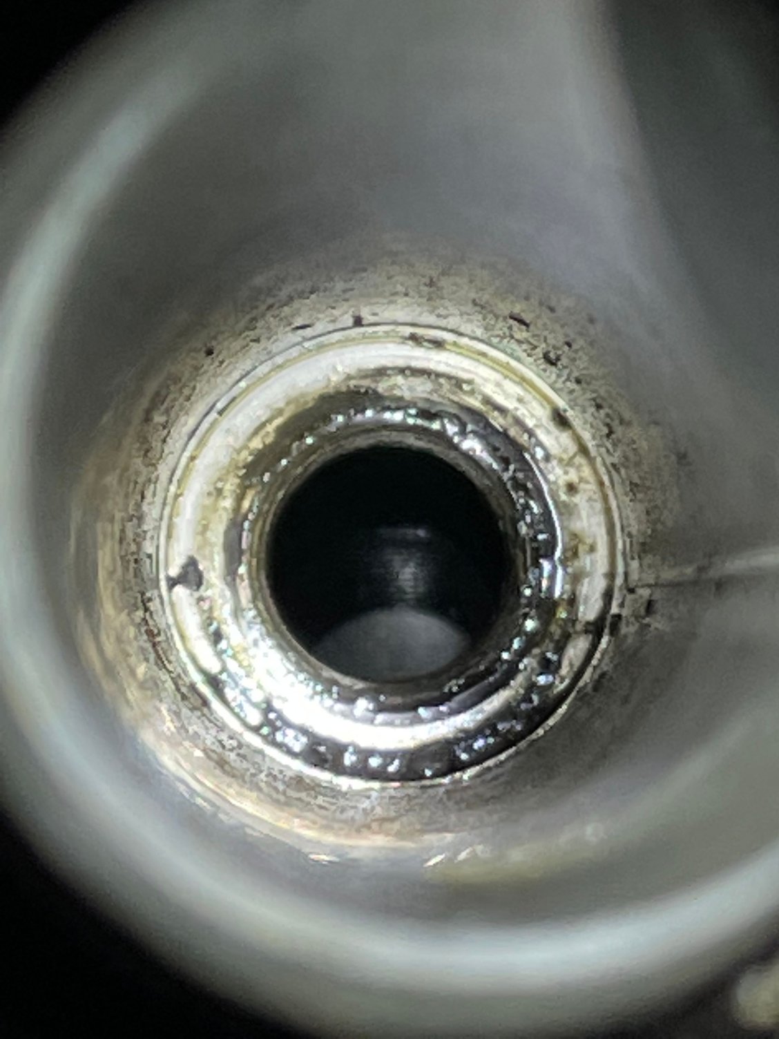

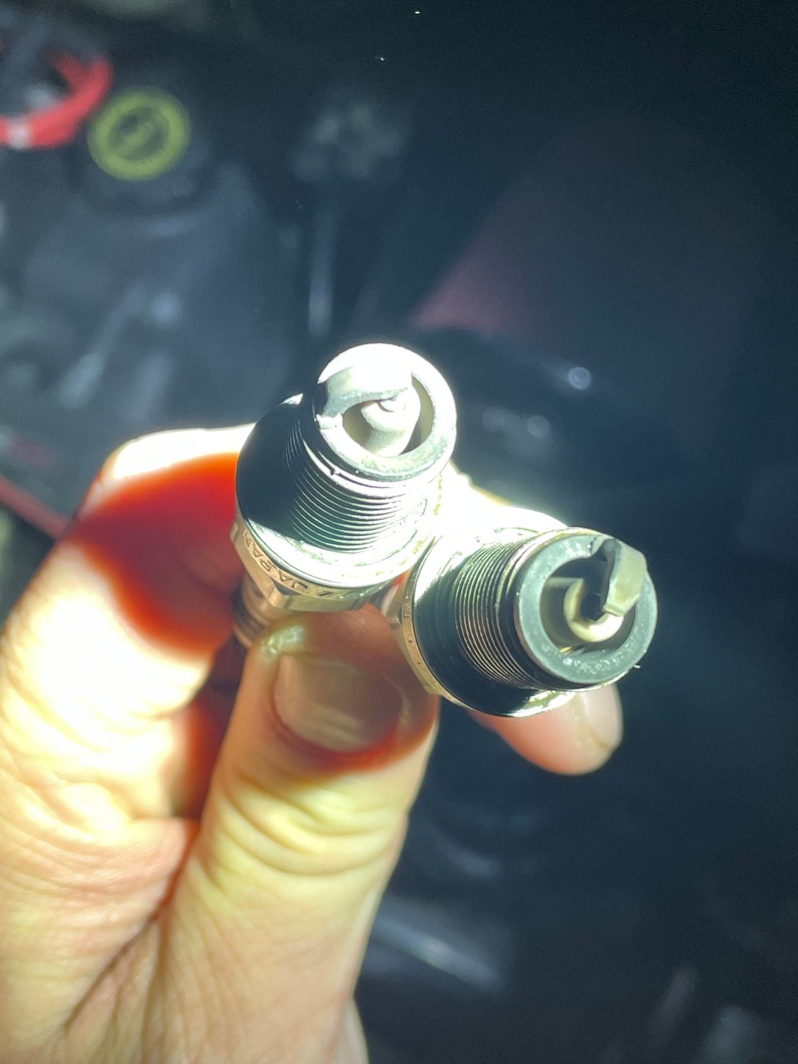

i figured out the problem, thought I’d post my results because almost 99% threads never end with a solution,
Puddle of water in cyl 1, ^note this is a new head gasket too^
Plug #1, plug #2
Note to self, send head to machine shop no matter how broke you wanna be doing this work so you don’t have to do it twice .

I'll take a wild guess: he said he replaced the head gasket and still had coolant intrusion into one of the cylinders. He then lamented not sending the head to the machine shop during the head repair.
It sounds like the engine overheated and warped the cylinder head. Since the head wasn't machined back to flat, the coolant intrusion to the cylinder persists.

I just came in to say its probably the head. Mine was the exact same. Replaced EVERYTHING and it refused to stay cool. Head kept pushing the water out and creating air pockets in the coolant system. Had head decked, new gasket, no more overheating problems.
To anyone searching this later, go to Autozone or Oreilly or Advanced and get and head gasket leak detection kit. Its just a rubber stopper on a graduated cylinder with a little hand pump. You add blue fluid to it. Follow the instructions. If the fluid changes colors to green or yellow (can't remember) you have hydrocarbons in your coolant which means the head is bad. Then you can attack the problem. If it stays blue, then you know its not the head and can look elsewhere.
