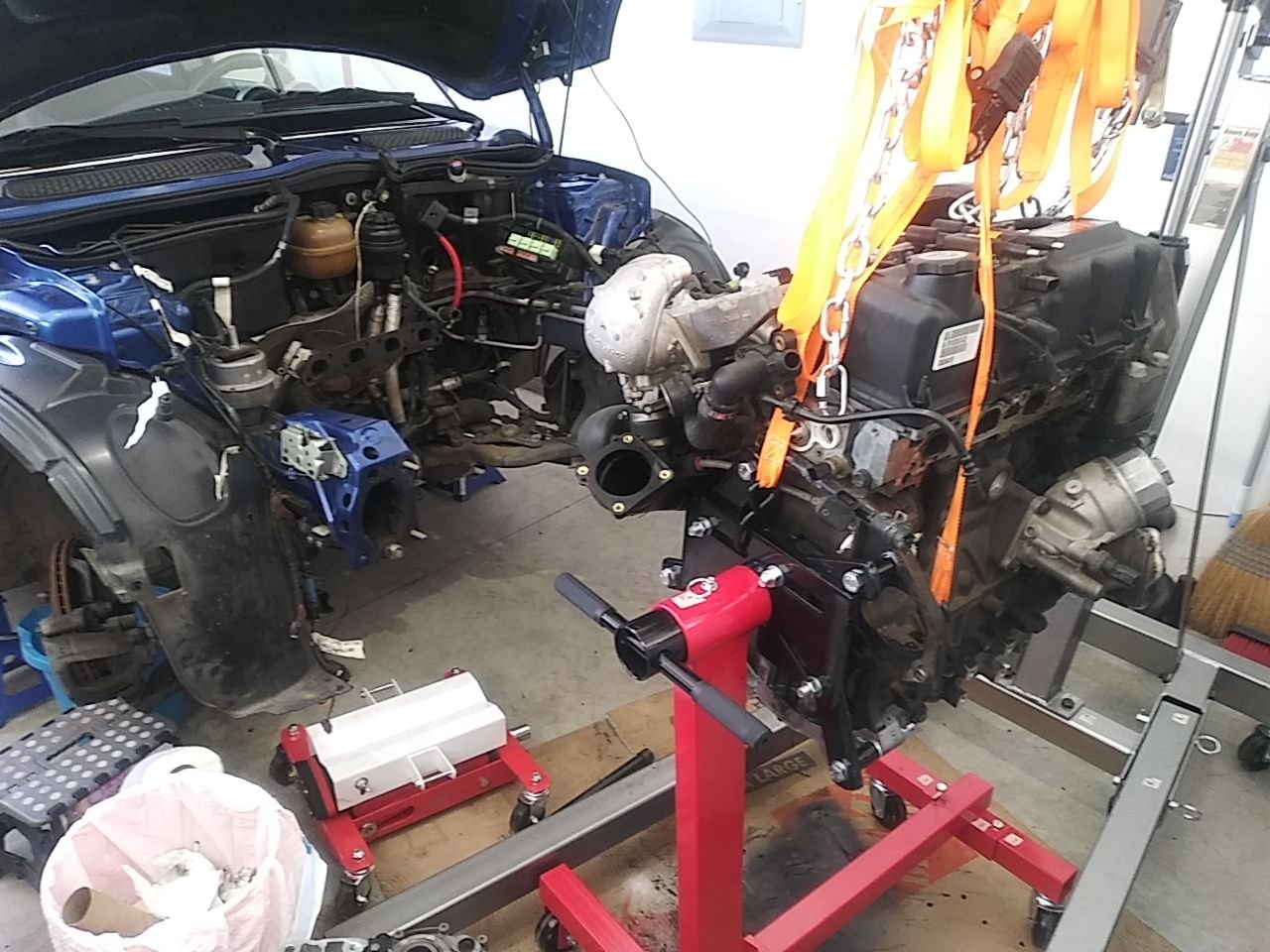

I’m retired and wanted a project car so I got an ‘05 MCS, drove it for 350 miles and parked it. I have near zero experience working on cars but I did work on my own touring motorcycles for a lot of years. I studied Mod Mini’s excellent videos and removed the engine and transmission. I worked super slow, took 300 photos and bagged and labeled everything.
My goals for owning this car are: tool up, do all the work myself, learn everything about the car, enjoy the car for many years. I like the car the way it drives so I won’t be doing performance mods.
I did some things comically poorly. Jacking the car up, jackstands, maneuvering the engine around after it was on the crane, seperating the tranny from the engine were all crazy clumsy but nobody saw a thing and nothing bad happened. If Mod Mini didn’t specifically show how to do something on video, I really fumbled around.
Reasons for taking the drivetrain out:
Always wanted to take the engine out of something
Didn’t know anything about the MCS, want to learn
I sure enjoy working on anything BMW made, love the design approach
Car has almost 100k miles, needed a good going over
Suspected a thrashed throw out bearing (it was)
Wanted to know if the clutch needed changing (it does)
Wanted to service the Supercharger (surprise, the oil is clean in there!)
Suspect a worn out cam chain tensioner
Want to inspect or replace the plastic cam chain guides
Original radiator hoses look terrible compared to the rest of the car
Now that I’m off of the Mod Mini videos for the time being, I seek wisdom from the collective. As I have questions I’ll post them separately. Many thanks to everyone here.

Some people are in the camp of 'if it ain't broke, don't fix it' but you've got a car with 100k miles and an unknown service history, I assume. I'm personally in the camp of replace it before it fails.
I'd replace the water pump, front main and rear main seals, oil filter housing and oil cooler gaskets, crank sensor O-ring, harmonic balancer, belt tensioner, idler pulley, power steering hoses, rad hoses, radiator, thermostat. Make sure you radiator fans are working properly, too.
In terms of hoses, use realoem.com to find the part numbers then punch the part numbers into a MINI parts vendor like thebmwminipartstore.com or minipartsdirect.com. There's a lot of hoses and plastic components, and they're not cheap - I went through this last spring when I bought my 2006 back and started a restoration project on it.

I did same thing when swapping out a auto trans drivetrain for a manual tran drivetrain. When I replaced the clutch I replaced the guide tube,
lubricated the shift arm shaft and replaced the seal on the transmission input shaft.
Things that are easy to do when engine is out
replace starter (if needed)
replace O rings on oil cooler (one to block and two on the aluminum heat exchanger
replace timing chain and guides (I elected not to do this because had evidence it had already been done)
You have access to subframe so good time to do PS reservoir hoses and maybe pump if it looks bad and any bushings, inner ball joint ....
Other things I did
Supercharger service with a new green gasket for the inlet duct
Water pump with new connection flange (On all my projects this has been corroded)
New knock sensor
New Crankshaft Position sensor
New thermostat + housing
New Camshaft Position sensor
New upper motor mount
New belt tensioner and belt
New oil pan gasket
New valve cover gasket and spark plug tube gaskets/O rings
New spark plugs
New hose from pipe to Water pump
New hose from inlet duct to BPV
Probably leaving a few things out. I have gotten crazy on some projects and replaced the shift cables and the slave clutch cylinder

These are probably the best reasons I’ve seen on the forum for pulling the engine. It looks really clean, did your clean the engine bay or motor before these pics?
For the above, I would go with the o-rings and just an inspection on the pump and flange since you’re willing to go back in if you have to.
I would change the rear main seal. Going back that far is a big job, and I would rather go back in for a less likely premature failure or bad install, than rely a seal with that many miles on it.
Bad things can happen if the tensioner fails so I would change the idler pulley and tensioner now, unless you know they’ve been changed recently. More importantly, check crank pulley as these are known to fail, with the same bad results that are possible with the tensioner, or just upgrade it now to an ATI pulley.
Other things to consider:
  • Strut tower reinforcements - it looks like your towers might be mushroomed. I went with the VIP reinforcement/bar combo, but the reinforcement plates are also available separately.
  • A new passenger motor mount - Hard to tell from your pic, but it looks like there’s a hydraulic fluid stain from a leaky mount. Also, if you care what your engine bay looks like, use a mild cleaner and test it in a hidden area. The paint in there, and in the hatch jambs is not clear coated and will wipe away with most solvents and cleaners.
  • Hoses.- I would probably go with stock. The engine compartment is pretty cramped and I wouldn’t want to take a chance on a slightly different shaped hose rubbing or causing some other issue. Same with the coolant, MINI coolant isn’t really that much more and unless there’s no MINI dealer around, I would go with that.
  • Crank position sensor o-ring. This often leaks
  • Supercharger pulley, belt, and colder plugs - Unless you really want to keep your car stock, this is a great, low cost mod.
  • Coolant tank - these often crack at the seam and many go with an after market aluminum replacement.
  • Bushings or anything else which requires removing the subframe like the FCA, sway bar, and steering rack bushings.
Also, the power steering pump and passenger seat occupancy sensor might be under recall so check for that. If so, many dealers charge extra for the power steering hoses so you should have that covered with your planned replacement.

Takeaways so far:
Is it worth it so far? To me, YES. Who knows if this car is going to start without a fight, but I’ve learned so much so far. Before this job I had no idea where the location was for the water pump, thermostat, or shift linkage or what they looked like. I’d never touched a clutch plate, never held hose clamp pliers, never held a tap, and certainly never stretched a torque to yield bolt before. I had worked on many motorcycles for general maintenance so I did know my own way of doing things but I’m a car NOOB.
My NOOB process:
I worked very slowly, learning as much as I could before completing a task. That included RealOEM parts diagrams, part numbers, parts diagrams, parts supplier web sites, Bentley manual (not a great manual but necessary and useful), NAM Forum searching, YouTube videos and taking frequent breaks to meditate or sleep on things before proceeding. Often that was a huge long process but that is the way I have to do this. It’s my process. That’s why it took more than 6 months to service everything so far.
I took over 400 photos, numbered them, carefully filenamed them, logged them into a photo log, and backed them up on a second device. Kept a journal logging all my steps which wasn’t real useful as I relied on the photo log a lot more. I bagged and labeled all nuts, bolts, brackets, small parts. Over 50 bags with inventory cards of what was in the bag. Also photographed every bag with the inventory card. Labeled, photographed and stored the larger pieces onto shelves. Also labeled and photographed lots of parts on the engine and in the engine bay. This was great insurance for an ignorant mechanic. Trying to video anything didn’t work for me. Video is a lot harder than it looks on YouTube.
Take engine out: 6 weeks (just follow Mod Mini Videos)
Service everything so far: 6 ½ months
Left to do: Connect everything and get this baby on the road
Reasons I was so slow:
1. Ignorance and Inexperience
2. Parts Inexperience and Parts Wait times
3. Had to Build My Infrastructure and find many first-time-ever solutions
My preferred parts companies:
1. Pelican Parts for most things
2. Out Motoring when Pelican doesn’t work out
3. Amazon but not for many MINI Specific Parts.
I have a lot more to do and nobody on earth knows when this car will actually start and drive.
Thanks to all the Forum members. The collective knowledge here has been invaluable.
