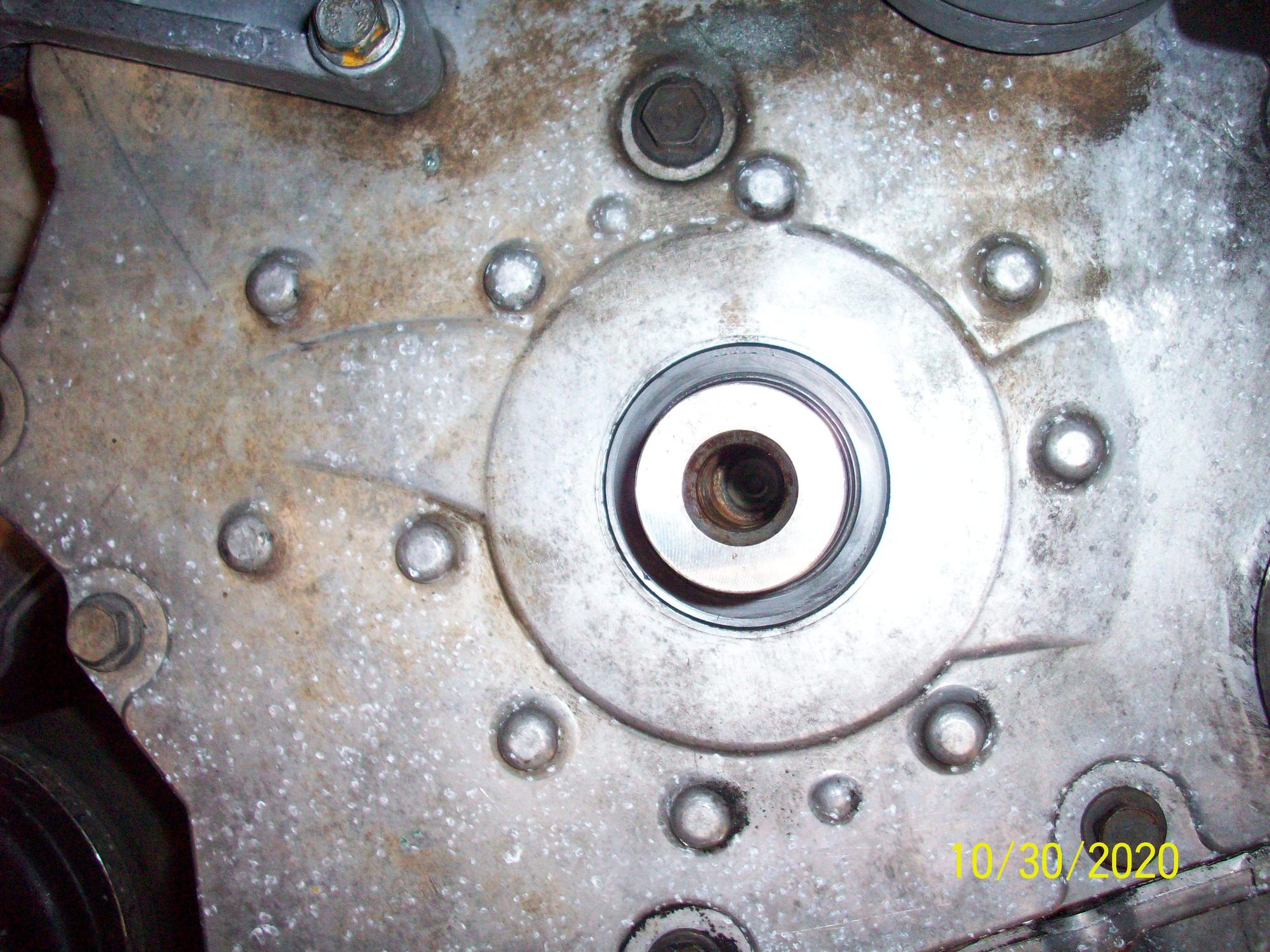

Holy *****, your engine is quite dirty. Compare it to my picture from not too long ago. Good luck with the rest of the remaining jobs!
Old Nov 8, 2020 | 03:43 PM
Fishbreath's Avatar
Fishbreath
Joined: Mar 2013
Posts: 83
Yup, I'm pretty sure that's from the crank seal.
I had a bit of an adventure getting the old tensioner off—I tried to take it off the rear bolt with a socket, and by the time I realized I didn't have enough clearance, I wasn't able to swap the ratchet back to turning right because it was touching the frame rail. (It was one of my beaters with a back plate that turns to set direction, rather than a lever). I ended up having to cut into it with a dremel until the ratcheting mechanism failed, so I could turn the socket with pliers to put the nut back in. I did end up having to take the motor mount brace off to get the top 10mm nut out—I couldn't get at it from below because the spring was in the way, and since I don't have ratcheting wrenches, it wasn't really feasible to get from the top.
At some point before I resorted to cutting the socket, I think I slightly bent the bolt—it didn't want to go in cleanly, so I set it aside and will try with a good bolt on Tuesday (when the shipment arrives; metric bolts are like hen's teeth around here). Hopefully I didn't damage the threads in the block, but even if I did, it feels like I have more than enough to get a shorter bolt or a bolt with some washers in.

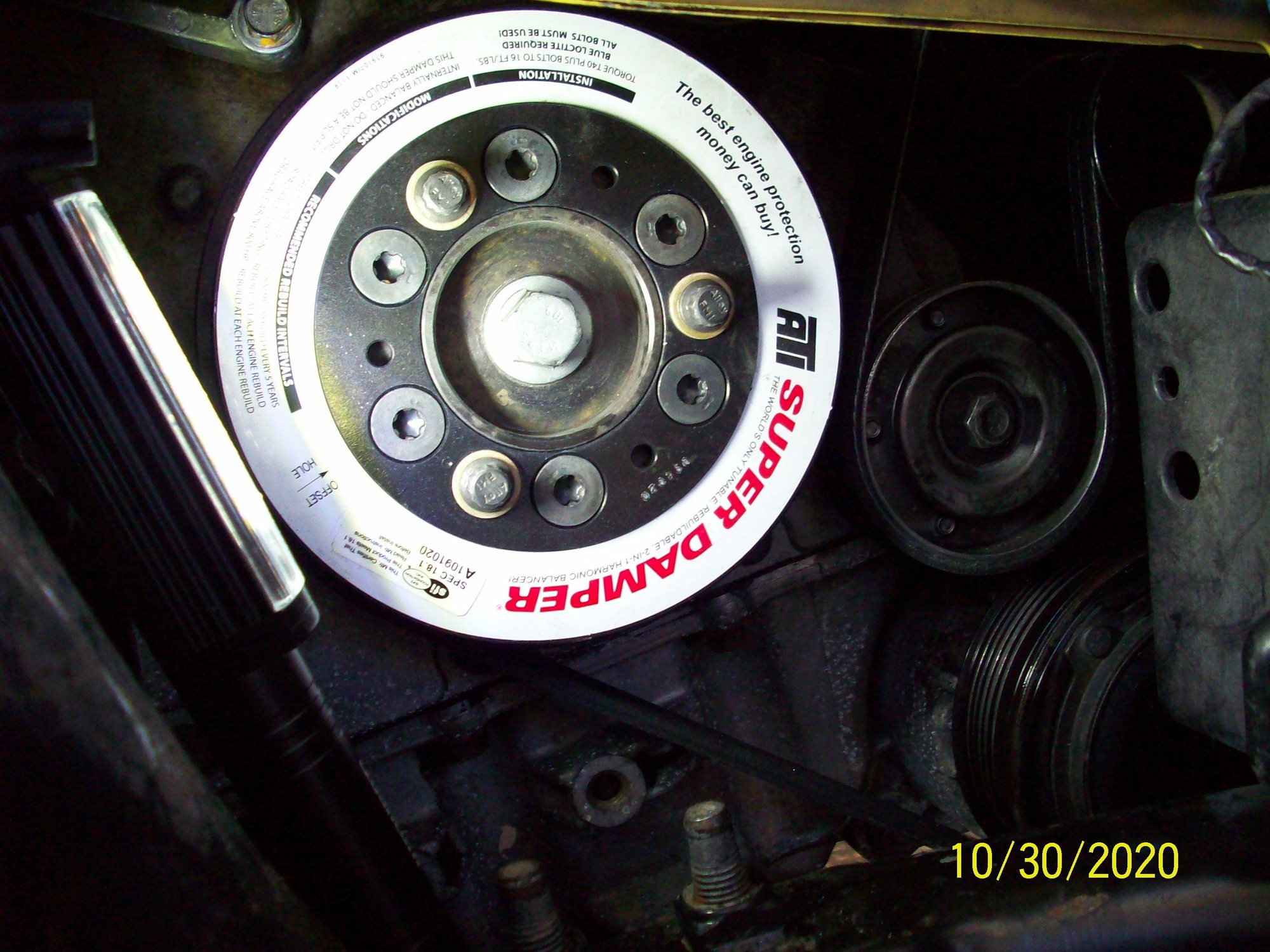

I was hearing some increased noise from my 04 JCW that sounded like the Super Charger, but read that it could be a number of things being telegraphed through the engine block. Then on a trip up to KC the belt tensioner broke in half, the belt became a bird's nest, and the damper shell was trashed by the broken tensioner parts rubbing it. I had to trailer it back home and I've replaced the tensioner and had the ATI Super Damper rebuilt and it is back together. I hoped that the tensioner was the cause of the noise, but there is still a noise that sounds even louder than before the tensioner broke. (or maybe I am more paranoid about it now). I had hand turned the fixed idler pulley, AC compressor, and alternator and all felt smooth and turned OK before the other parts were replaced, and now listening with a mechanic's stethoscope the idler pulley and alternator body sound OK and the loudest sound is at the pivot end of the belt tensioner and at the super charger body just below it. I also noted that the bolt in the center of the damper seemed to be turning slightly off center when I started it to check the tracking of the new belt, and it was as if the Damper was "shaking" a bit. I took a video which I will try to upload here that is not in good enough focus to show the off center turning, but does have the audio that I am hearing. I am now wondering if the tensioner breaking was the result of something else rather than the cause. Any suggestions on what I should check next?
BTW, if you order a Gates belt tensioner you will get a Litens unit in a Gates box (the same brand unit that broke) and to torque the M10 bolts on the tensioner it helps to have a flare type crows foot for your torque wrench because a socket, even a short one, will not fit.
BTW 2, I bought my Mini in 2017 with 180K miles on it from a BMW nut who had recently rebuilt it with New Clutch, Pressure Plate and Flywheel, New Struts, springs, shocks and ball joints, New Radiator Support All new engine gaskets, New Battery, New belts and hoses, New Belt Tensioner, New plugs and wires, New Supercharger and Water Pump, New Motor Mounts, New Starter, New front axles, New Windshield, New Clutch slave cylinder, New Hood Struts, New Brake Calipers, Alta 17% Undersized Supercharger Pulley, ATA 2% Oversized Super Damper, Alta Intercooler gaskets, M7 Speed Cold Air Intake, Adjustable Short Shifter, Konig Wheels (215/45R17). I've driven it just 5727 miles, mostly to local car shows and on British Car Club drives.
The videos don't seem to upload so here are some photos
Converted my mov files to MP3 sop you can hear the audio. Guess the site will not take mp4 videos and the mov files are too big to upload.

I just added an audio file converted to MP3 from the video; it started at the damper and then moved up to the top of the engine where the sound was even a bit louder. I'll see about uploading the ones I converted to MP4 somewhere. I wanted to send one to the guy who built her to see what he thought, but my email provider won't send even a 25 MB file.

So, is the sound in the video similar to yours? I can take a Db reading if that would help, but It sounds pretty loud to me.
