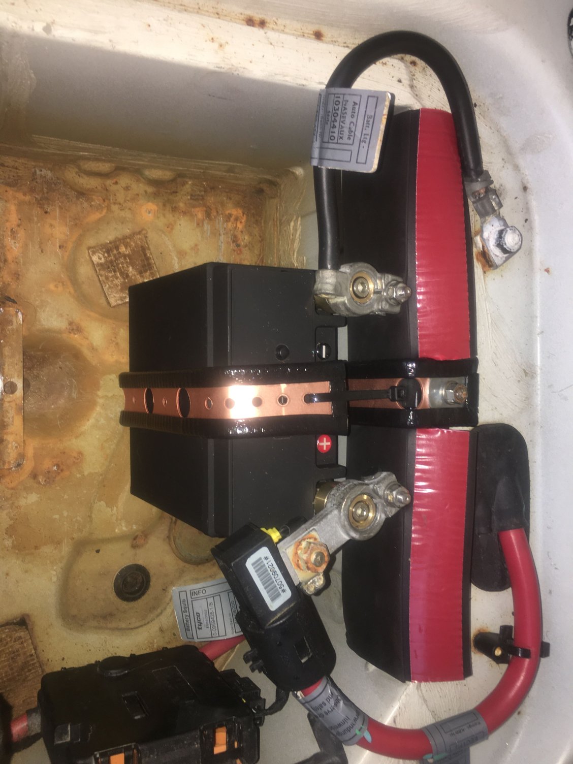

Then i decided to upgrade the battery to a 2.5lbs lithium battery. So Tiny. Needed to find room for my meth install. Anyways. Car started. But now The DSC and the TPMS lights are on. I can’t turn it off from the toggle. I tried resetting the TPMS, That didn’t work either.

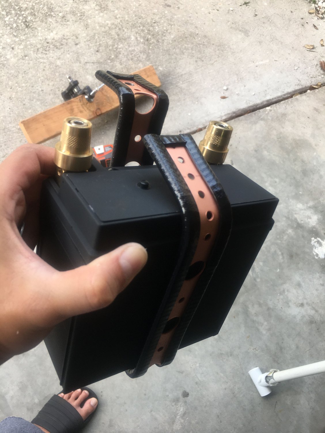

my homemade batte tu holder. Still have to finish it. Got an aluminum one in the making.
