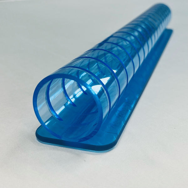

Its great following along with your work.... and thank you for putting all the time and effort into your posts and photos.
Take a look into these blocks (my 2¢).... much better than any of the rubber blocks on the market... I use them in my work on classic wooden boats and in my own car work... they truly do make a difference in the final product.
https://www.linearblockingtools.com/
Thanks! I spent some time on their site and those are definitely some different looking blocks! I like the 'Cadillac block' that requires two people to use! If I were going to go into this field as a side gig (which I am definitely NOT interested in doing, I think I would definitely look into those. My hard rubber larger blocks do a really good job with large flats and even gentle curves, but I am looking for a small hard block for stuff like runs and dust nibbing, and they make only large ones... at least that I could see.

Originally Posted by jcolletteiii
...My hard rubber larger blocks do a really good job with large flats and even gentle curves, but I am looking for a small hard block for stuff like runs and dust nibbing, and they make only large ones... at least that I could see.
I guess it couldn't hurt to sacrifice one of your large blocks and cut it in half or to the size you desire? ....After all you know where to get the larger blocks if needed.
'got a bandsaw?
