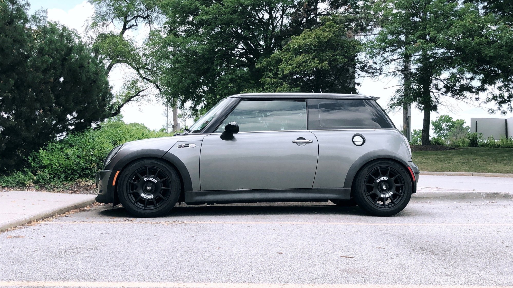

Jul 15, 2018 | 11:01 AM
So I ended up going with Black Sparco Terra's 16" with Kumho Ecsta PA3's in 205/55 R16. Ride quality has definitely improved as well as traction and feel. I do feel a noticeable amount of roll with the higher sidewalls, looks like a sway bar is going to be on order. I'm curious to see how these will handle during Chicago winters. Thanks everyone! I'll post pics soon if anyone's curious.
Reply 0
Jul 15, 2018 | 12:23 PM
Sparco Terra 16x7's with Kumho Ecsta PA31 205/55 R16
Reply 1
