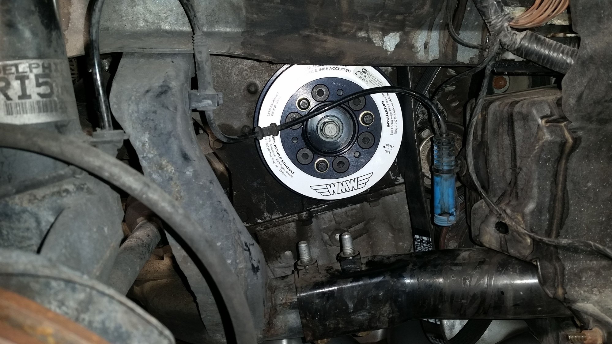

I finally got around to pulling the CSP and it broke in two in my hands as soon as it came off the crankshaft. After a failed attempt at removal using an autozone generic puller kit that didnt fit, I bought the puller tool from WMW and it couldn't have been easier. I had the old harmonic damper off and the replacement ATI part on (also picked that up from WMW) in less than an hour. A couple of lessons learned from this install. The first is that when you reconnect the the nut holding the top portion of the ground wire to the motor mount (this is removed to enable increased access to the top of the serpentine belt area), be aware that it doesn't take much torque to break the housing shelf from the motor mount. Second, when you're putting the ATI harmonic damper on the crankshaft, be aware that the bolt provided in the ATI kit will NOT push the harmonic damper all the way onto the crankshaft - you have to use the original crankshaft bolt to seat the damper the rest of the way (about the last finger width or so). This is mentioned in the WMW directions but probably worth noting again here. Thanks to WMW for getting my very well packaged order to me quickly (2 days) with no missing parts. Also, thanks again to everyone for your inputs.
Stock Harmonic Balancer
WMW ATI Harmonic Balancer
Great Pic, Glad you got it together and back on the road.
