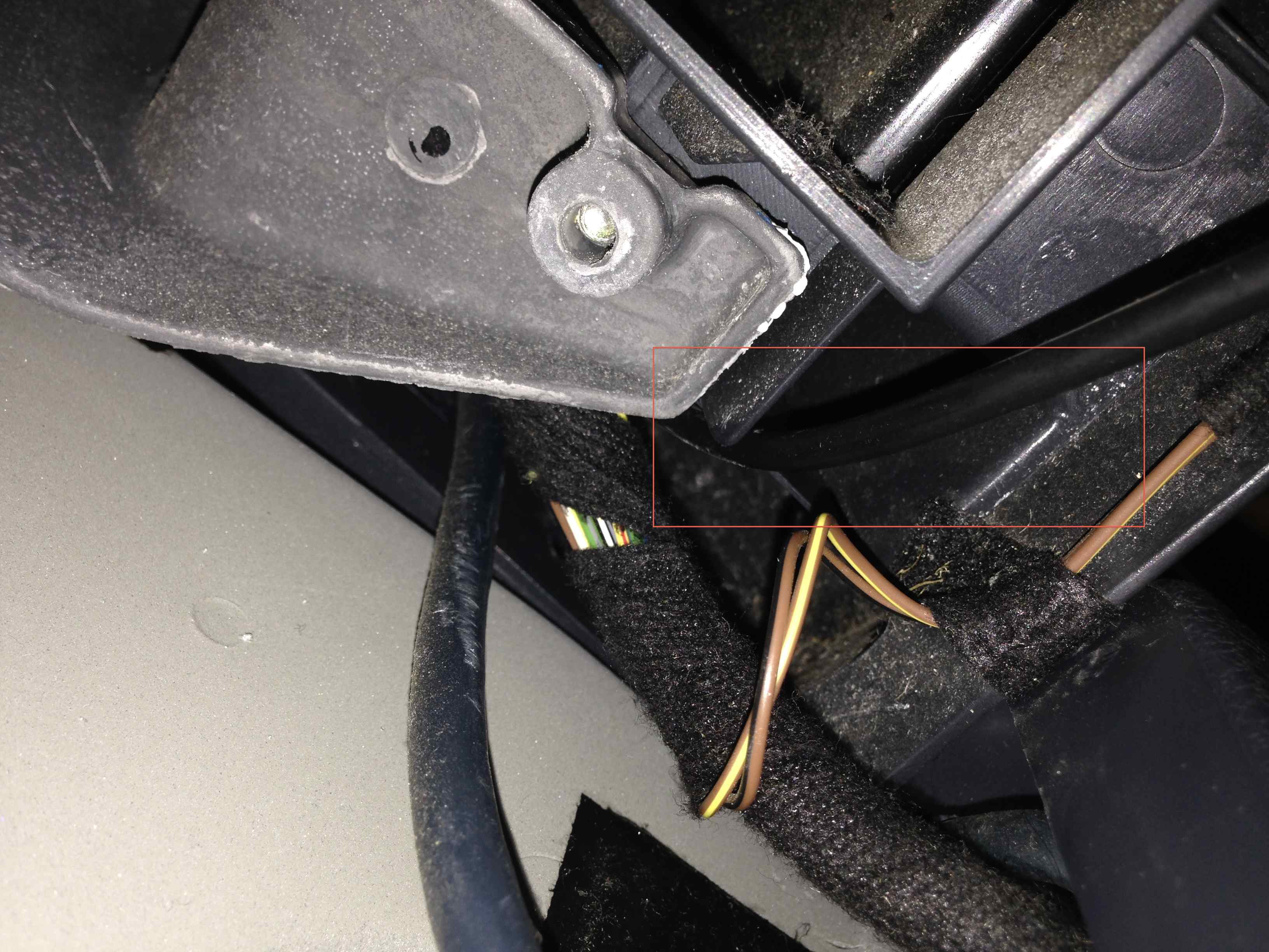

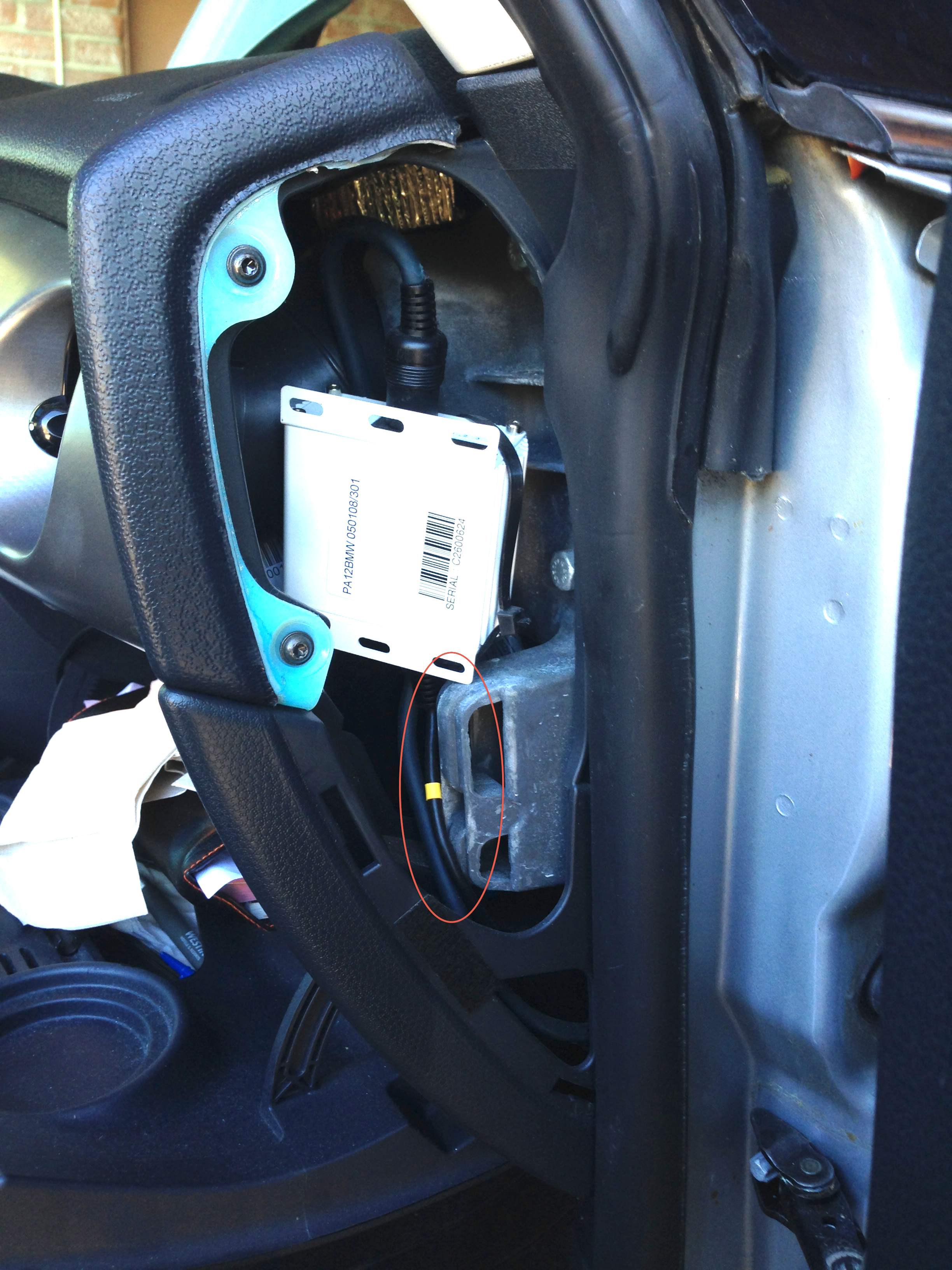

I included a photo of how the adaptor cable runs beneath the glove box toward the passenger door, just lateral to the hood latch. See red oval and rectangle. These pics are taken looking up under the glove box.
I pulled off the panel that's lateral to the glove box where the passenger door closes. It turns out the ipod adaptor interface was stashed behind that panel and the adaptor cable was connected to the interface (see white box with bar codes on it). The gray wire then appears to snake behind the glove box back toward the stereo.
I removed adaptor interface and will see if it addresses the battery drain issue.
