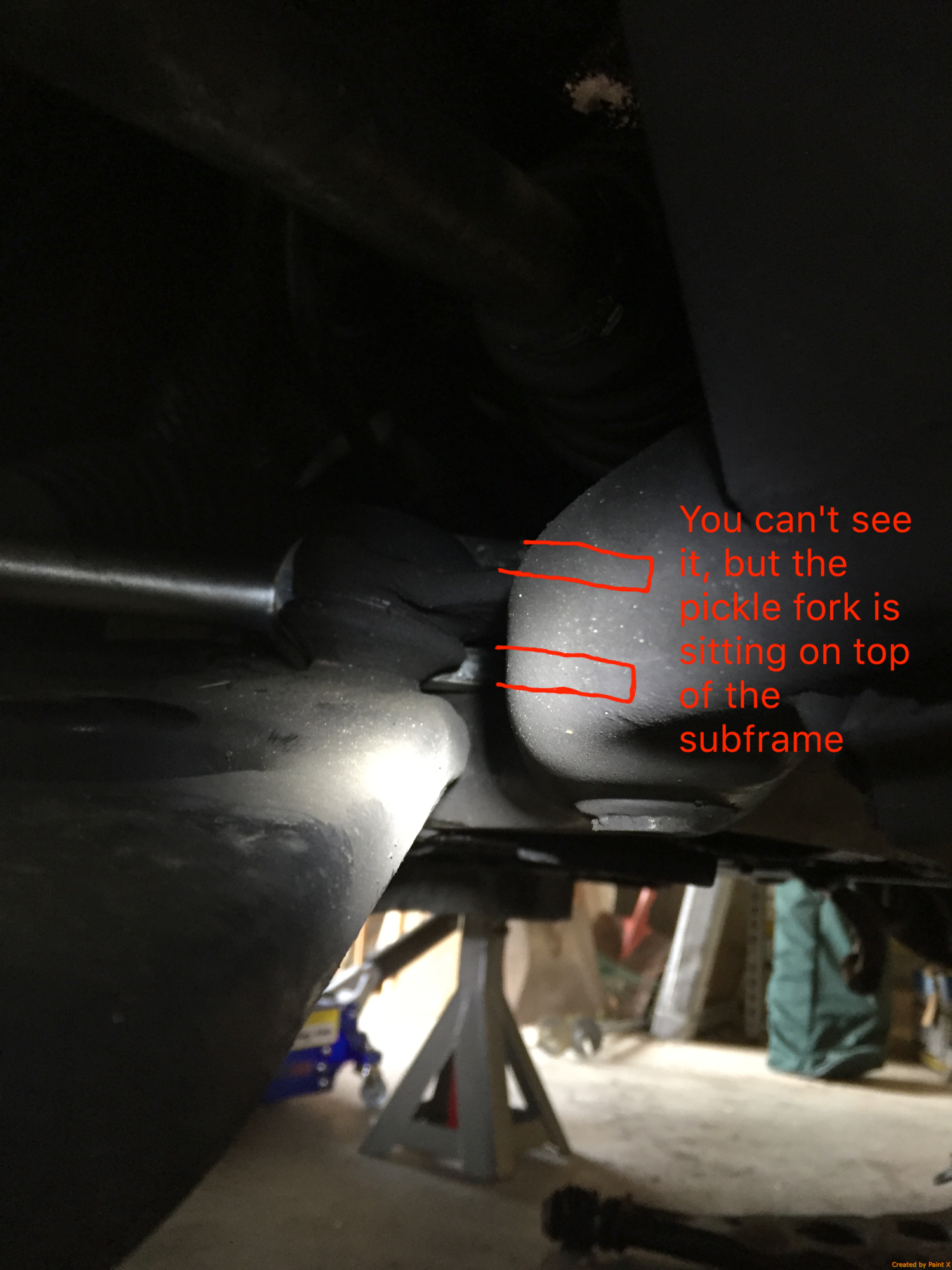

NOTE: THIS IS THE TRICK!!! From here the instructions apply to both sides.
6) Use the 16mm wrench to loosen the 2 big bolts that hold the inner balljoint to the subframe. They are very tight, but if you have a big wrench or are strong they're really not that tight. I have an 8" wrench and broke them all loose with one hand. Do not remove the bolts (one side is directly under the axle shaft and you can't remove it). Just turn the bolts that hold the balljoint bracket to the subframe counter-clockwise about 6-7 times so that both sides can lift about 1/2-3/4". You'll have to play with this to get it just right... but you'll figure it out.
7) Lift up with one hand on the control arm directly under the inner ball joint. This should make the ball joint bracket itself lift up until it hits the heads of the bolts. This creates a nice gap where you can wedge the pickle fork in BELOW the balljoint bracket and ABOVE the subframe. Stick the pickle fork in SIDEWAYS on the side of the balljoint. Depending on which side of the car you are doing, it should be on the side facing the REAR of the car (IE the passenger side you stick it to the left of the balljoint, on the driver side, you stick it to the right). Use a small flathead screwdriver to keep the boot out of the way when you are sticking in the pickle fork - This way it won't get damaged!
8) Use a 16mm wrench and start tightening the bolt on the same side where you stuck the pickle fork. Turn the bolt until it is tight, but not super tight. Just make sure it's putting a lot of pressure on the pickle fork. You shouldn't be able to move the pickle fork by hand.
9) Bang the control arm from the top with the mini sledge hammer. For me it took only 3-5 hits to pop the balljoint loose.
10) Remove the 2 13mm bolts that connect the outer balljoint to the wheel hub. Tap it with a hammer and it will fall out.
11) Tah-Dah!! Now you can pull the control arms out.

It's difficult to tell in the photos but when you have the pickle fork in all the way it actually wedges between the subframe and the control arm. It looks like tightening the bolt would only be squeezing the pickle fork between the balljoint bracket and the sunframe, but it doesn't. It actually pushes down on the control arm as you tighten the bolt.
The purpose of the pickle fork being shoved in that way is so that when you tighten the bolt next to it, it puts pressure between the subframe and the control arm (pushing them apart, in the same direction that you need them to go to pop loose). Theoretically if you just tighten that bolt to kingdom come it may have popped the balljoint out on its own... But I didn't want use the bolt alone to break the balljoint loose, as I feared I might break or strip the bolt or damage the subframe... but just having a lot of pressure pushing in the direction that you want things to go will help break the ball joint loose when you smack the control arm with a hammer gently.
I got the idea from an old bimmer i worked on once, which had a ball joint that was so difficult to remove that it broke 2 balljoint separators (not pickle forks). I ended up putting a balljoint separator on, tightening the bolt until it was tight (but not too tight) and then whacking the control arm with a sledge hammer and it popped right loose. I think the intense vibrations alone from the sledge hammer may have allowed it to pop loose once there was constant pressure on it. I'm not sure, but brute force was certainly not doing the trick. I applied the same concept here and it worked wonders.
The trouble is that if you just whack the control arm with a hammer the force will go in every direction and will probably be absorbed by the bad bushing or The balljoints. Of course this could also damage your balljoints, Or anything else you may hit by accident. Inserting the pickle fork ensures that when you hit the top of the control arm with the hammer, all of the force goes where you want it to, and the vibrations from the hits help it break free if it's rusted in place. Mine popped loose in 2-3 medium force hits.
