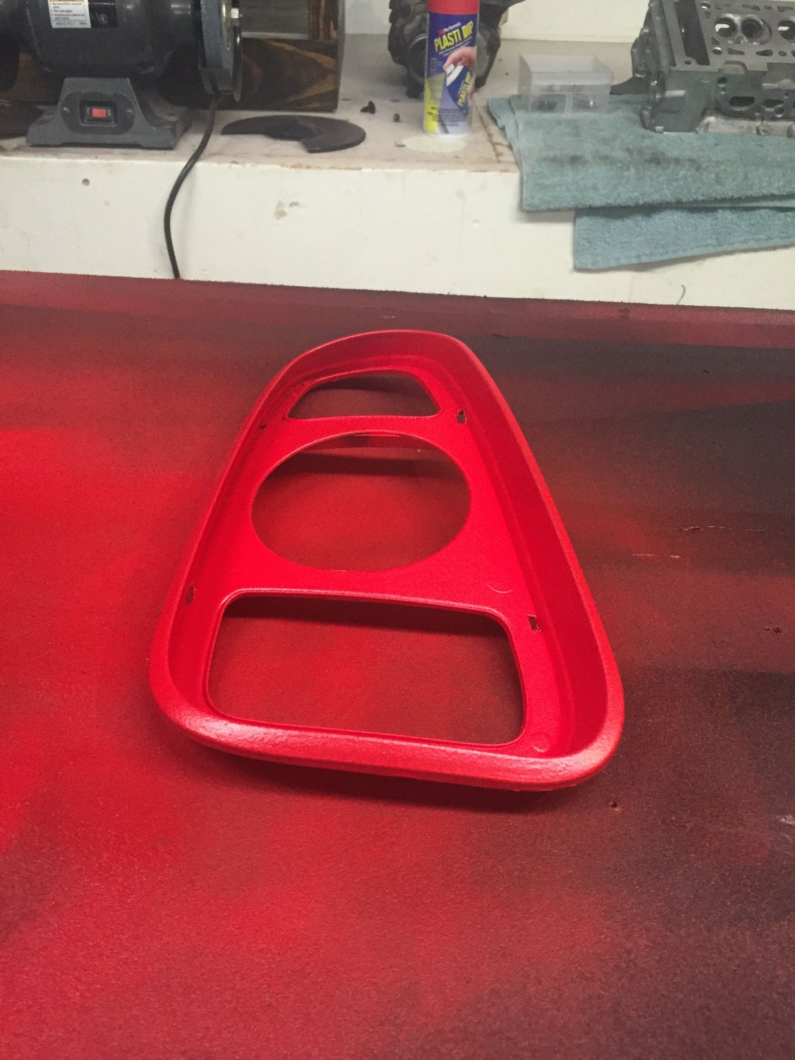

Old Aug 15, 2016 | 10:40 AM
  #64
KnighTT's Avatar
KnighTT
Joined: Jul 2016
Posts: 120
From: Atlanta, GA
For once, in my 1,000 DIY projects I have done in the past, these actually turned out exactly how I envisioned them in my head before I started.
What do you all think?

Nice job on the tail lights! How did you separate the lens, and what did you use to reseal them?
Old Aug 15, 2016 | 12:07 PM
  #67
KnighTT's Avatar
KnighTT
Joined: Jul 2016
Posts: 120
From: Atlanta, GA
There is a decently clear line where the lens is glued to the housing. You just take a high speed dremel, at about 80% throttle, and put a FINE cutting blade through that channel. That way you are cutting a minimal amount of material.
The trick is here to only take about an 1/8" cut in depth. Otherwise you can actually cut through the entire thing right through the chrome piece inside. Then you take a flat head screw driver and very gently pry the clear lens from the housing. Work all the way around. Do this slowly. I was pretty paranoid of cracking the lens.
Then, you just sand the housing and lens mating surfaces when you are done.
What I did was tape it back closed in 4 areas to minimize the gaps and hold it together. Then I tacked it closed with x6 1/4" spots of epoxy glue. (just in case I ever had to open them up again, it would be easy to pop those).
Then I just finished it with Permatex black automotive silicone all the way around. Matches the color exactly, fills in the gap, seals them up, and looks great. Plus I can cut it back open if I ever need to freshen up the color, if it ever leaks, etc.
