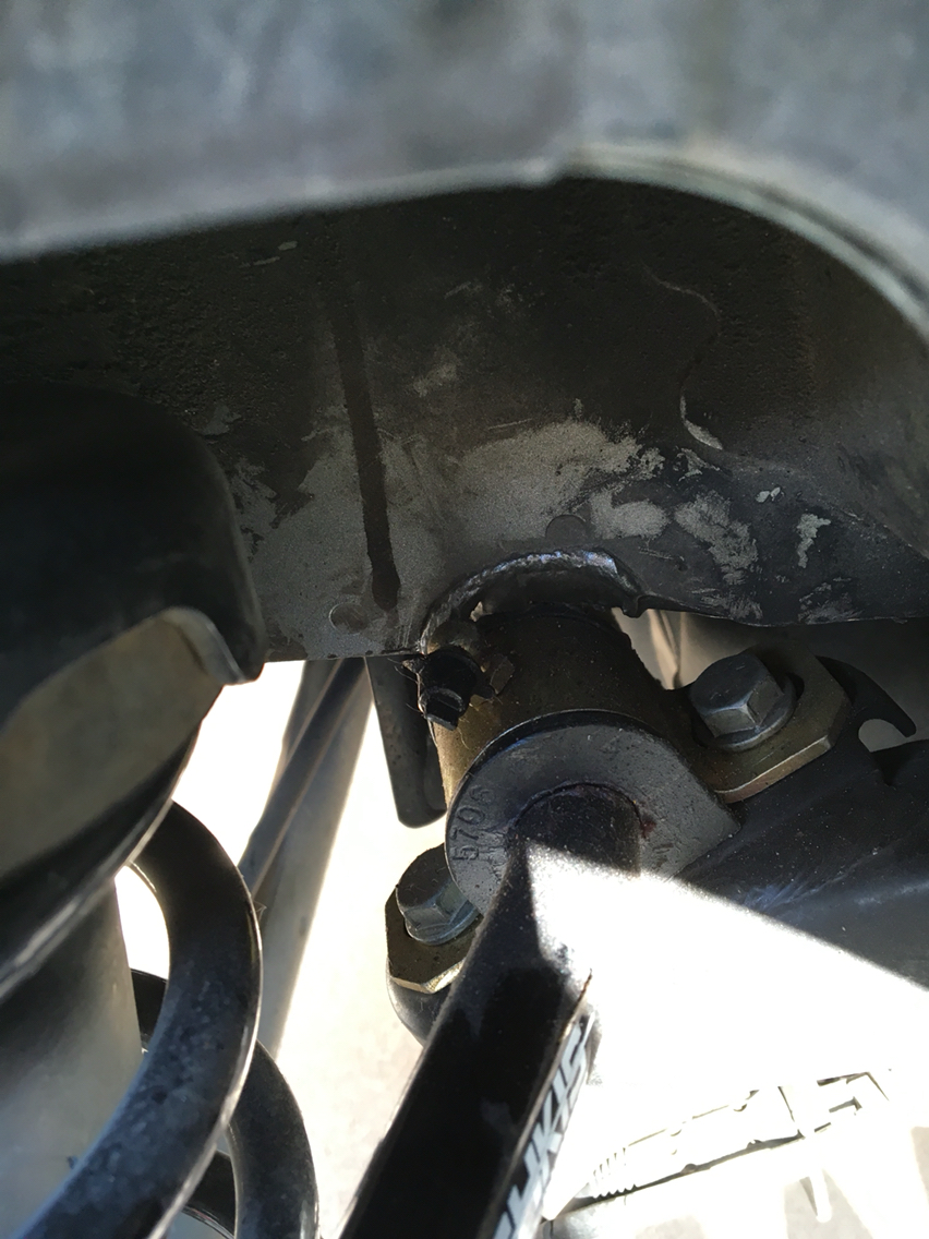

So I've had this magnaflow on since I've owned it. Came with the car, and never heard the knock before. Just noticed a missing hanger on my Mini tho? I posted some pics of where my away bar sits, as well as the drivers side hanger that I believe is missing, passenger side is the same way. If that's what it is, I'm curious as to why now it has started doing this. I've got the car up on stands to try and figure out the problem. Oh
Someone said maybe my hatch... What should I look for?
Attached Thumbnails Rear End Knock-photo714.jpg   Rear End Knock-photo102.jpg   Rear End Knock-photo976.jpg

That sway bar and bushing look normal; same a mine. That bar is really tight in there but it is unlikely the cause of your noise.
The hatch latch has been known to make noise but that would come from the center of the car. Also it tends to be more of a creek than a knock. If the sound is coming from either side then you are likely looking at sway bar bushings and end links. If the shocks were removed and they likely were to put in the sway bar, then check for loose mounting bolts. If you have the stock springs and shocks then it is unlikely that the top nut has come loose. I also doubt the exhaust just up and started to make noise.
