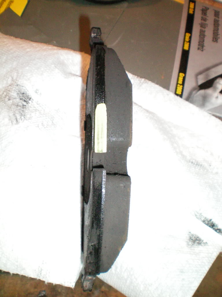

fourth: easy to visually check pad wear. When the material is as thick as the backing plate it is time to start thinking about new pads. With most pads there is also a bevel on the edge and when you can no longer see bevel, the pad is usually down to backing plate thickness or less. Here's an almost new GEN2 MINI front with some white paint on the backing plate - same angle as you'd see looking thru the caliper

here's a pad that's ready for replacement
