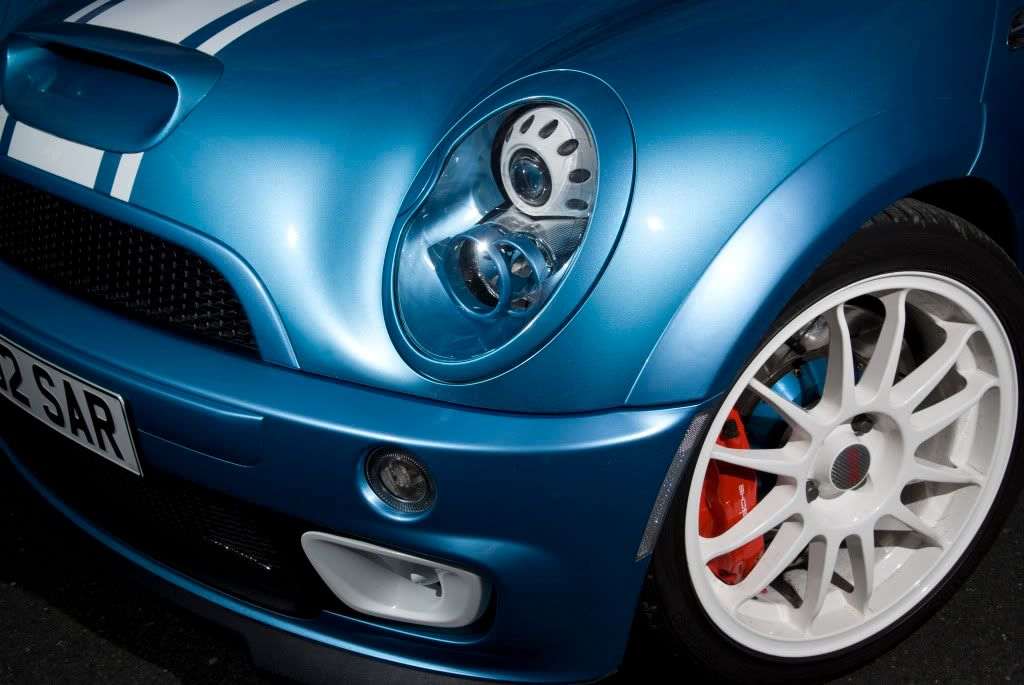

Sorry you got tapped, but glad your okay. Those OEM lights are so awesome. I really doubt anything you get will be better. Just search for the joey mod on here and black out the housings and keep the lights you have. I have even seen them color matched. Here's a nice example:
And here's the how to:
http://www.zerotohundred.com/newforu...post1063677876
Ahhh so wise
It's true they are....
Truth be told I've saved all of the oem parts I've removed and I plan to refurbish them. I do one day want to put this car back the way it was many years from now. Another thought I had about the lights is id love for them to stay the way they are now and enjoy my cross country exploits with a nice replacement pair....I think I'm just being overly particular

Just got this pic of my MINI through email and had to share it!

Very nice, really like the angle and effect.
