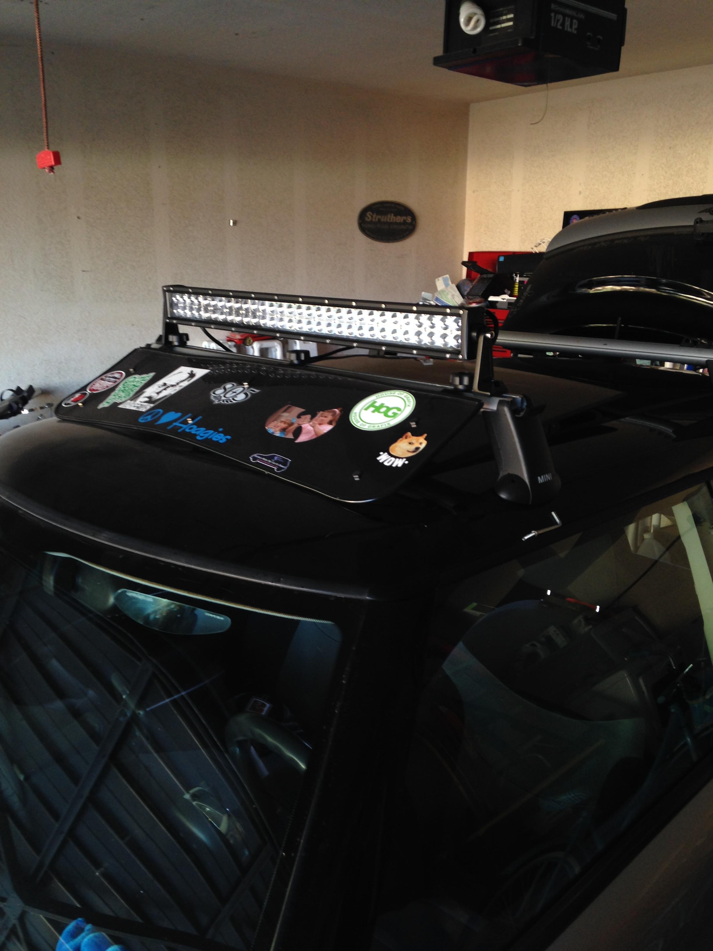

I have a 35" bar that I wire up every now and then. It has spot and flood lights. Not something for the daily drive though.
Nice idea and design, congrats!
What about the wiring from LED to The car wiring??
Old Apr 2, 2015 | 07:26 PM
ImThaBean's Avatar
ImThaBean
Joined: Oct 2013
Posts: 93
From: MidMich
I ran the wiring through the sunroof. Power leads went to the battery in the rear through the headliner and then the power switch to the front and popped it out by the sunroof switch. All the wiring stays in place, tucked away under the headliner. If I want to use it, I slap it on the roof rack and wiggle out the wiring. The wiring has quick clips.
