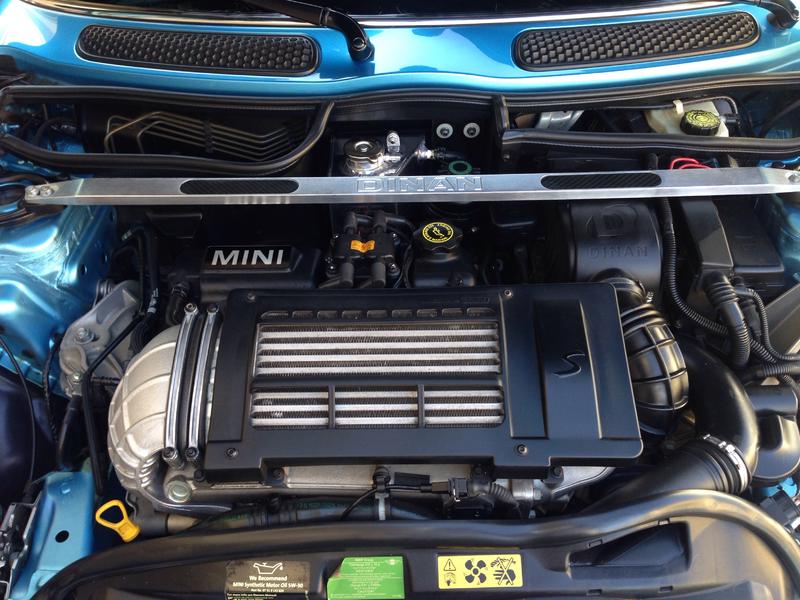

05'
05' s
Attached Thumbnails Show me photos of your front shock / strut tower brace, please.-image.jpg

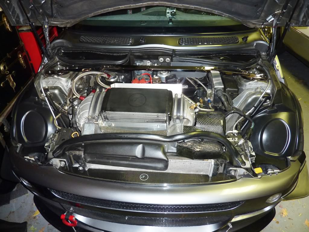

M7

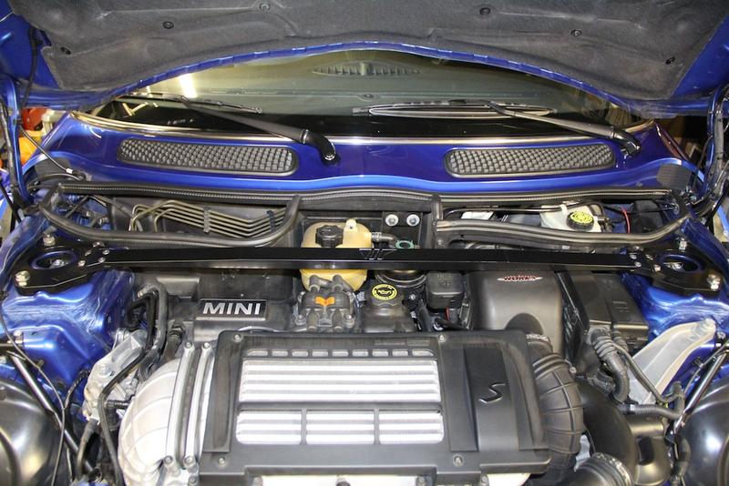

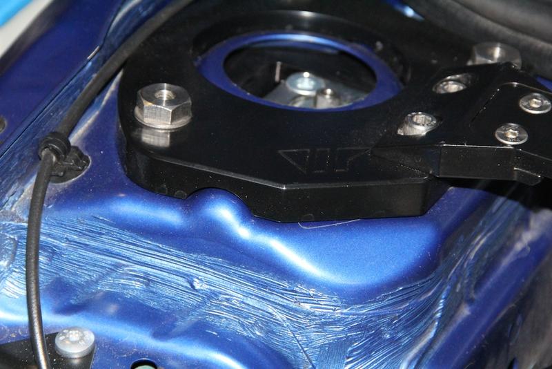

VIP Brace + JCW Box
'05 S with JCW airbox and VIP strut brace.

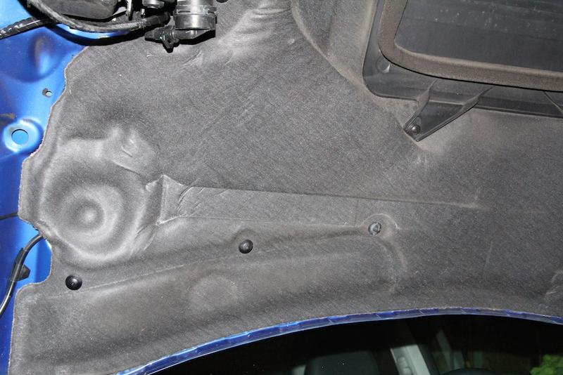

The craftsmanship and attention to detail are great. The tower plates are contoured to fit the towers, not squared off notches around a curved ridge. The custom T nuts make it so the plates are not recessed at the holes, leaving the plates at full thickness.
The hood padding did need slight compressing, but my car only had about 10K miles at the time. I sprayed the pad with water, then shut the hood and drove around to heat everything up. After a few times the padding molded itself around the bar and the hood line at the cowl was not bulging.
The only thing I really don't like about it is the VIP logo is machined into both plates, and the bar. Will post pics tonight.

VIP Brace with JCW Box Pics
Attached Thumbnails Show me photos of your front shock / strut tower brace, please.-vip-strut-brace-002.jpg   Show me photos of your front shock / strut tower brace, please.-vip-strut-brace-001.jpg   Show me photos of your front shock / strut tower brace, please.-vip-strut-brace-003.jpg   Show me photos of your front shock / strut tower brace, please.-vip-strut-brace-004.jpg

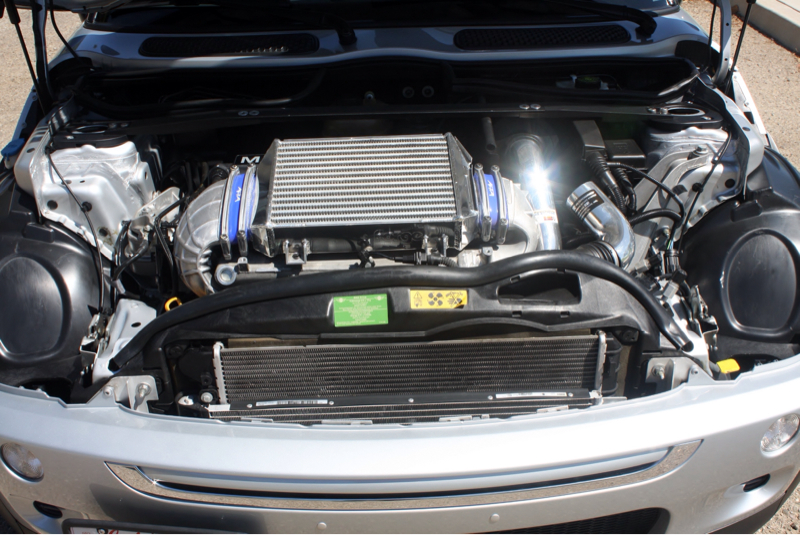

Another vote for M7.
There were a few M7 strut braces in the marketplace recently, not sure if they are still there, but worth a check.
Attached Thumbnails Show me photos of your front shock / strut tower brace, please.-m7.jpg
