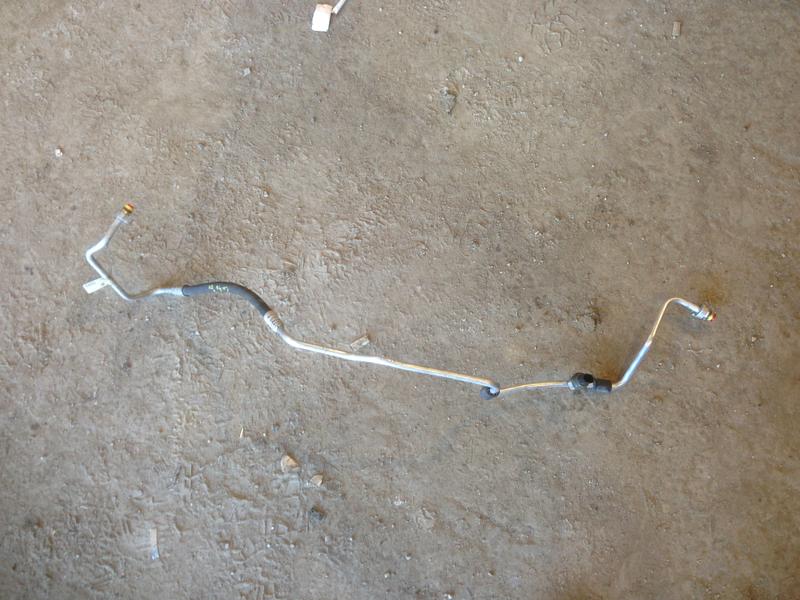

try this again see if i get the same results

ok new findings.
HIGH PRESSURE lower condensor line that runs to the expansion valve had a small hole rubbed in it next to the strut tower on the drivers side.
problem is the thing showed full and pressure was holding but it was so small the pressure did show but wasn't making it to the evap.
new hose on order.
Ill be sure to check the system and oil prior.
Old Jun 10, 2014 | 08:34 AM
Jones424's Avatar
Jones424
Joined: Mar 2014
Posts: 128
alright guys my issue is finally fixed.
My issue was the line I installed last time was slightly bent when installed and after driving for the last month it rubbed against the motor mount and rubbed a hole in it.
still doesn't answer any of my answers or my issues above guess the leak we so small at first didn't detect at first but still affecting cooling?
Attached Thumbnails R53 ac not blowing cold but full.-photo-1-1-.jpg   R53 ac not blowing cold but full.-photo-2-1-.jpg   R53 ac not blowing cold but full.-photo-4.jpg
Old Jun 10, 2014 | 08:35 AM
Jones424's Avatar
Jones424
Joined: Mar 2014
Posts: 128
and the line with the hole
