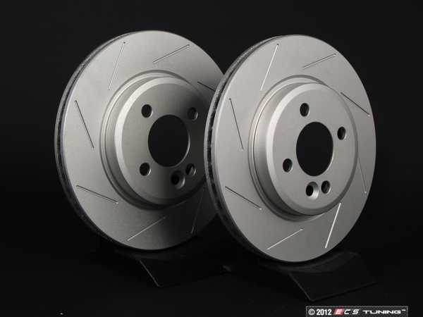

You will need the pre or up to 7/2006. Unless you have the JCW brake upgrade kit ( the one with the red JCW calipers with the JCW emblem. You will just need the stock size for the fronts and rear. The change after that year was the wheel bolt size among others.
10.86" (276x22) pre or up to 7/2006 Non JCW ( Not for John Cooper Works) for the fronts OEM part # 34111502891. And the rear up to 7/2006 any , as the share the same size as JCW brakes for Gen 1 MINIs. OEM MINI part # 34211503070 .
Here are some rotors For your 2006 R53 MINI Cooper S
http://www.ecstuning.com/Mini-2006-Cooper-R53-S-Coupe-L4_1.6L_W11B16A/Braking/Rotors/
We have our ECS Geomet Cross drilled and Slotted or just slotted for front and rear. We also have many other brands.
Dont forget to replace the rotor screw, one per wheel and put a little anti-seize on it when installing. Takes a T50 size torx bit.
http://www.ecstuning.com/Search/SiteSearch/07136772426/
Thanks and hope that helps. 7/2006 was a split year for the rotors.
