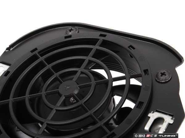

The PS fan which is for the Gen 1 MINIs only looks like this, of course early MINIs did not have the grille or the inline resistor.
P/S Pump Cooling Fan W/ Grille
http://www.ecstuning.com/Search/SiteSearch/32416857718/
Or you can just get the fan itself.
http://www.ecstuning.com/Search/SiteSearch/32416781742/ES2627297/

ECSTuning, I like the entire ps fan assembly you offer... much easier/quicker fix than drilling out the rivets to remove/replace the fan only. I'll likely be ordering that from you soon! Thanks!

You are welcome. But your fan (2006) mounted to the frame with the grille above should have screws holding it, like yours. I believe early MINIs w/o the grille came riveted in, which will have to be drilled.
Either way if you lost your grille or its old one is damaged, its a little easier with the whole unit. Unplug the main wire from the harness, two nuts at the main units bottom towards the rear of your MINI. Replace in reverse.

What is the size of the two hex nuts that hold the PS Fan assembly to the car?
Old Dec 4, 2013 | 11:20 AM
Posts: 36,762
Likes: 2,551
If I remember right I believe they were 13mm nuts. They hold the main bracket ( photoed above ) to the PS pump bracket.
