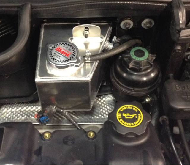

This was my permanent solution.
Old Jul 22, 2013 | 08:59 PM
brody78's Avatar
brody78
Joined: Apr 2010
Posts: 275
From: Connellsville, SW-PA
Looks like an epic replacement, any links to where to pick one up?
I think I FOUND IT HERE (I Beleive)
But if you could confirm that its the correct one that would be very helpful, +I've always heard there's a difference between this one (I Beleive) and the RMW one, with one of the fitments, so if you wouldn't mind letting us know how the install went it would be much appreaciated!
