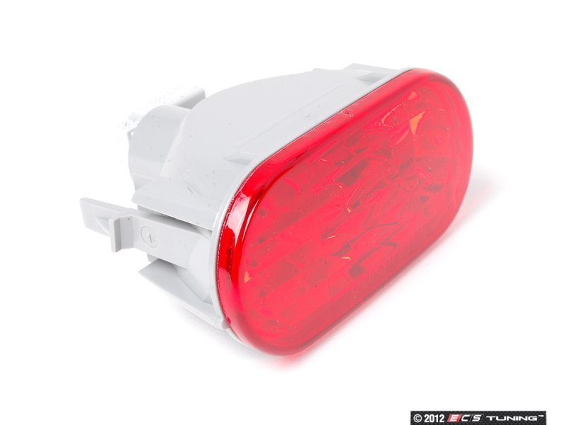

Reach under the bumper and press inward on the 2 tabs that hold the lamp in place. You will be able to push the lamp rearward out of the bumper.
http://www.ecstuning.com/Mini-2005-C...ght/ES2207526/
