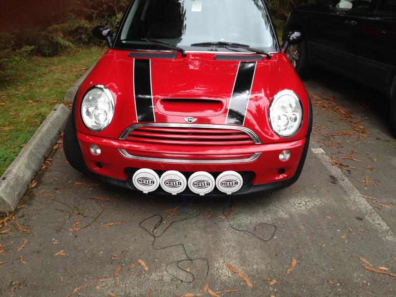

I just got done doing a alta light bar install with 4 hella 500ffs. It was alot harder than I thought it was going to be the bumper and hardware part was easy, but for some reason the wiring was a pain. If you go the alta route be sure to triple check where you mount them to the bumper. For some reason they did not give measurements.
