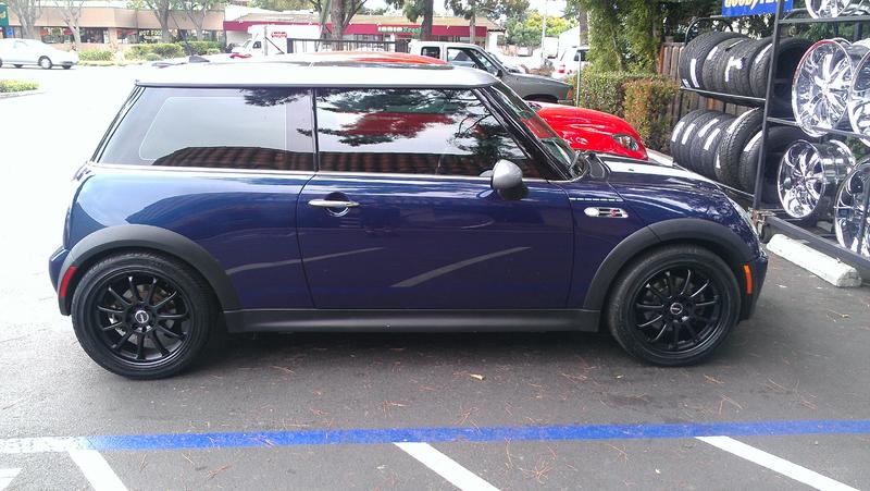

Hello Everyone,
I recently got some cheap rims and tire set up but they look cool The tire size was the same that was on the car stock but I would guess the offset on the rims is not what stock is since they rub over dips and hanging corners at high speeds. This only happens in the rear, anyone have some inner wheel trimming experience or advise on what to do? I got these rims and tires brand new cheap so I kind of want to make them work. Tire size 205/45/17. Any input would be great.
Thank you!

I have had rear tire rubbing issues when the suspension is loaded (weighted down, large bumps, hard turns) with my 2003 and 2006 MCSs.
Both were due to changing wheels or wheel offsets.
2003 was with 17x7 et38 wheels, 215/40-17 tires, and H&R lowering springs.
2006 was with 18x7 et52 wheels, 215/40-18 tires, 15mm spacers, and JCW springs.
Both cars required tirming of the plastic wheel arch and the plastic wheel well liner. I could see where the tire had rubbed on the plastic. I removed the tire and trimmed/ground-down the plastic with a dremel tool.
If you only have a very slight rub it might fix itself over time by the tire grinding down the plastic where it rubs. You can probably get an idea of how bad the rub is by looking at the tire damage.
Make sure the rub is not so bad that the tire is rubbing on any metal. I could see a little metal part on my 2006 that I had to slightly trim.

Nice thanks guys! I checked the tires when I first heard the rubbing to see if it was metal rubbing but it is just the inner plastic wheel well plastic. It is definitely worse when I have more than just me in the car so it gets a little annoying. I am sure it will wear itself down eventually but I like to go buy new tools since I dont have a dremel I think its time for one.
