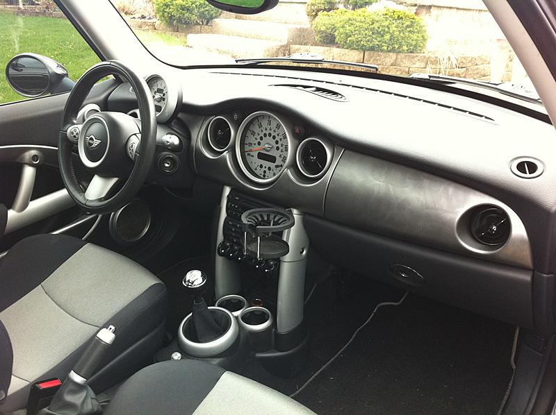

Was finally able to Drive the 2005 Cooper S today. In a word WOW. Smooth as can be, tight handling, and immaculate condition inside and out. Here are some pics:
I confirmed the MINI has the Premium, Convenience and Sport Packages, along with Xenon headlights, sport suspension, and Harmon Kardon stereo. Interior is cloth, which doesn't bother me. 85,000 miles, but again, the maintenance history tells me there is no reason to be concerned. My brother in law, how has a 2003 S made the comment that he needs to get his tuned after driving this one. He said it was noticeably better (quicker, more responsive) than his 2003.
I think I am ready to go on this one. Seller is asking $11,500 and as per previous posts has already replaced engine mounts, bushings and some other things and also is including a spare tire.
