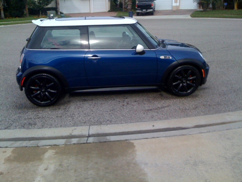

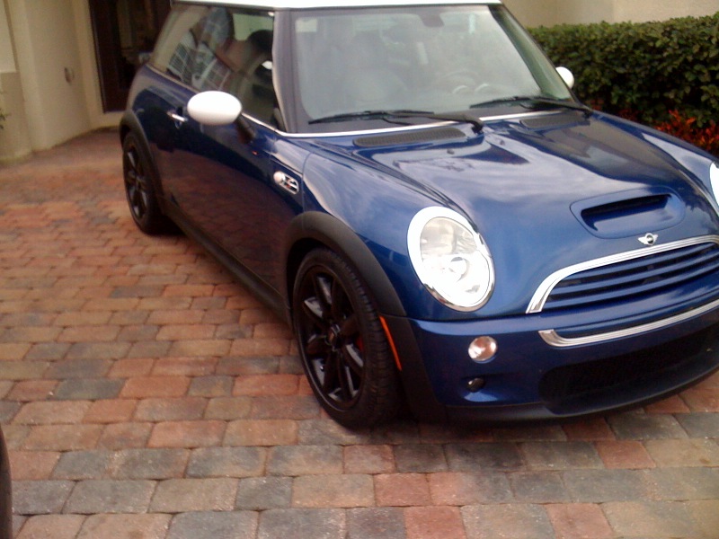

Sorry I did get it..... love it. I see some of the issues that you guys warned me of. The bushing, door locks, etc. I have already ordered the Alta 15% pulley and short shift kit. Sourced the 17' panasport stock wheels painted black with red calipers. I will post pics later today.

My new toy

Look Good, Hide the wallet...

Verrry niiiice!
