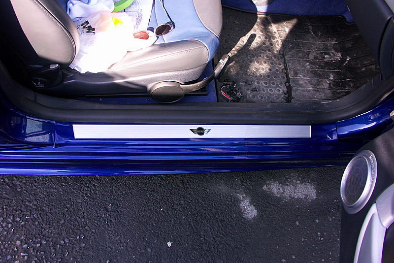

Here is what the aero-style sill covers look like. They did NOT come with my aerodynamics kit (which I bought prepainted from Classic MINI). I had to order these sill covers (and a rubber plug for the front tow hook hole) separately.
In order to remove the factory side skirts, you'll have to peel up the original metal sill cover. I was not successful when removing one of the original sill covers, so I opted to go with the aero kit ones instead (cheaper).
