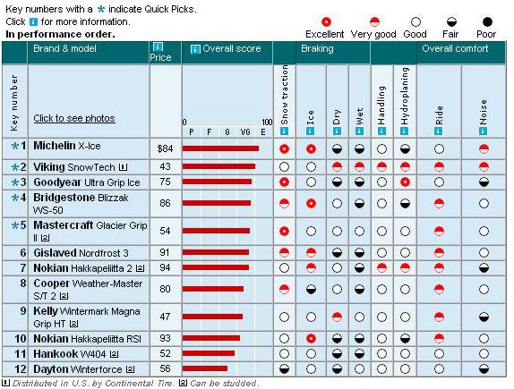

We chose the Michelin X-Ice (also from Tirerack) on 16" Kosei K1 racing wheels (winter in style!). The Blizzacks are also a great tire but are only the special "winter" compound for the first 1/2 of the tread from what I'm told (I could be wrong - best to check) then it goes to all season. The X-Ice are same throughout.
I'm from Canada where there is more snow and longer winter then almost anywhere else on earth (or at least it feels that way) and people who invest in winter tires always go X-Ice or Blizzack.
There was also a big article either in MotorTrend or Grassroots Motorsports last month testing a variety of tires that you should check out. I'll post the results if I can dig them up.
