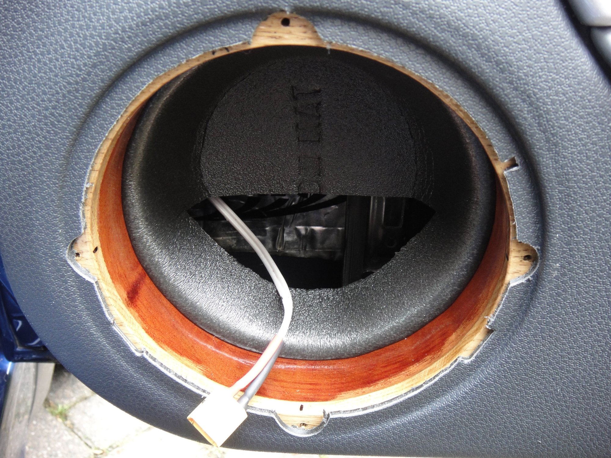

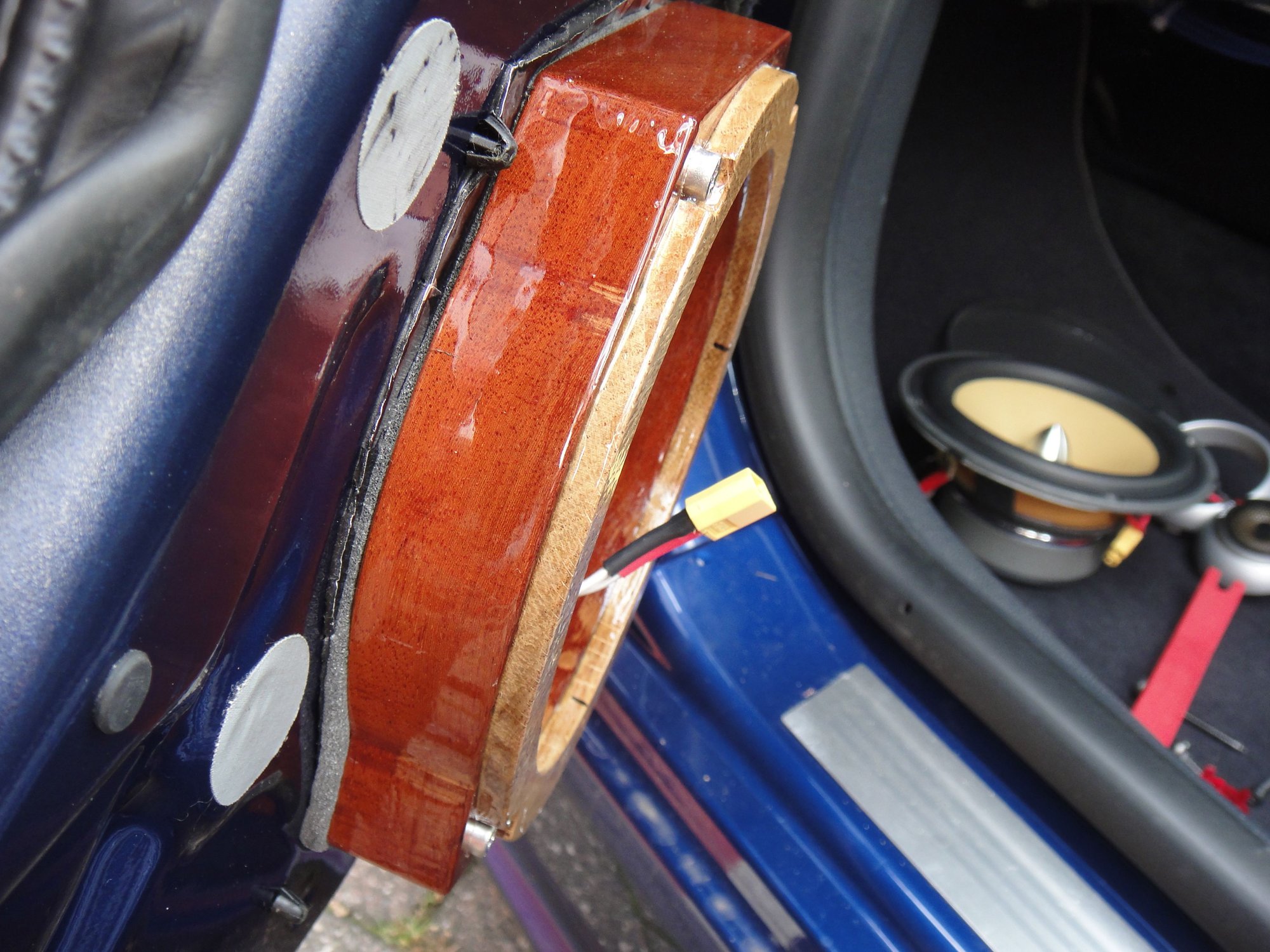

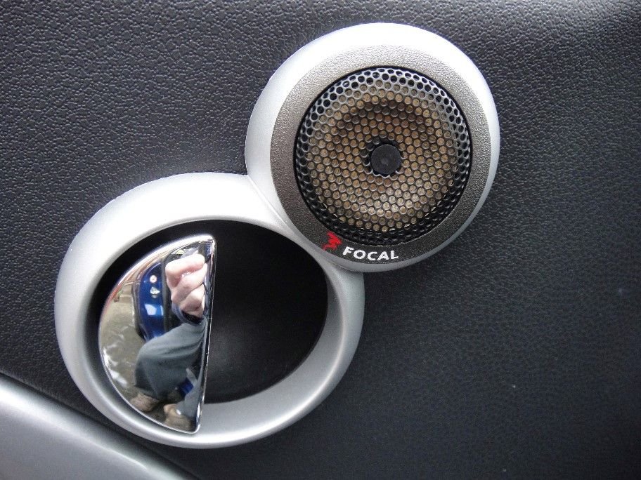

When fitting additional speakers, don't worry too much about physical size.
I was told I could only fit 5 1/4 inch speakers in the front doors of my R50.
I quite easily fitted 6 1/2 inch speakers, by making my own spacer rings. The Focals I fitted had large rear magnets, too. Not a problem.
Yes, you need to be careful about impedance matching, if using the standard H/K amp. I'd be using an aftermarket amp anyway, if it were me.

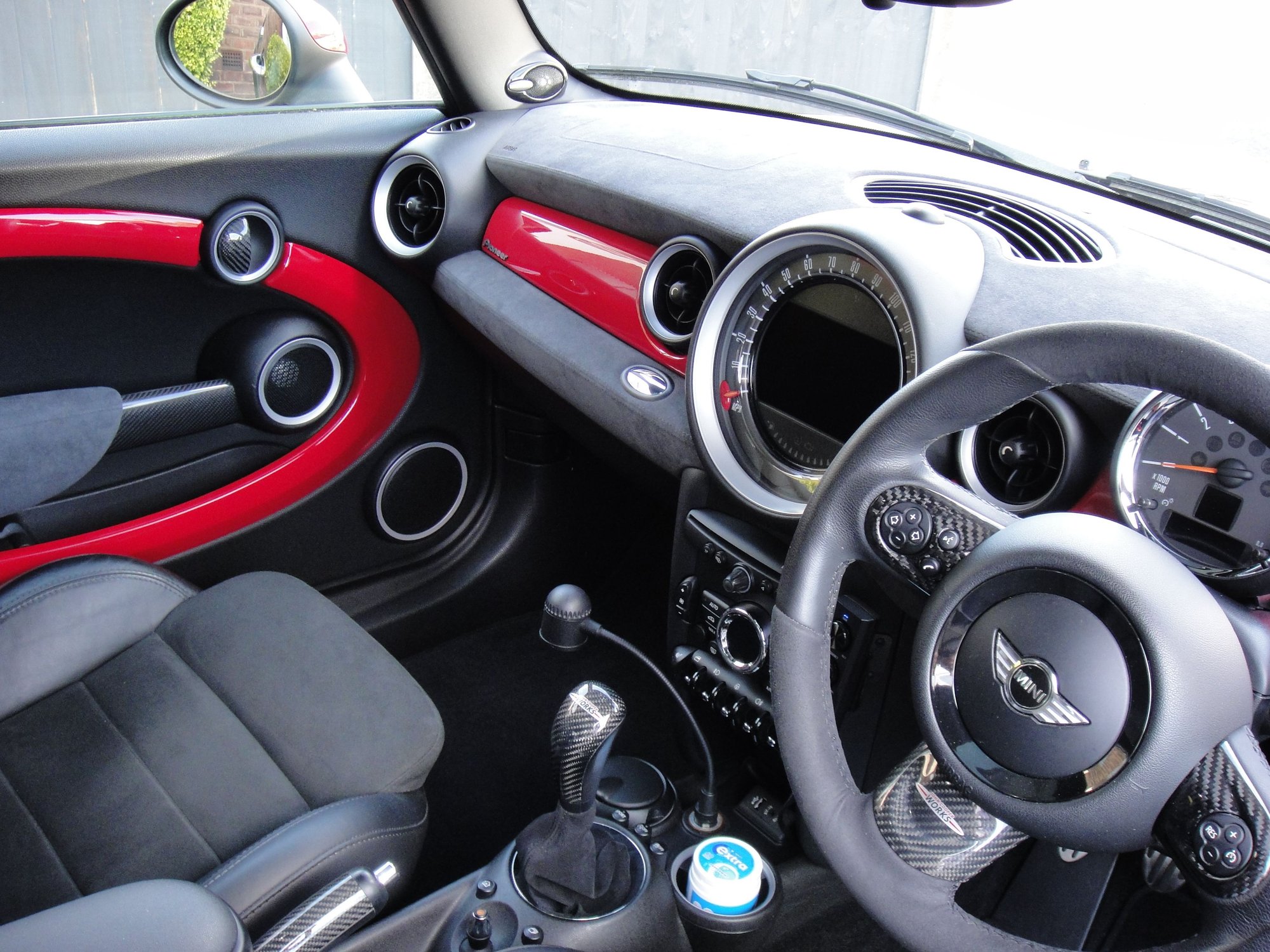

This is what I fitted in my 2004 R50. Sounded incredible!
Old Dec 26, 2024 | 08:21 AM
gauss66's Avatar
gauss66
Joined: Mar 2022
Posts: 416
Likes: 79
From: Florida
Very Impressive !

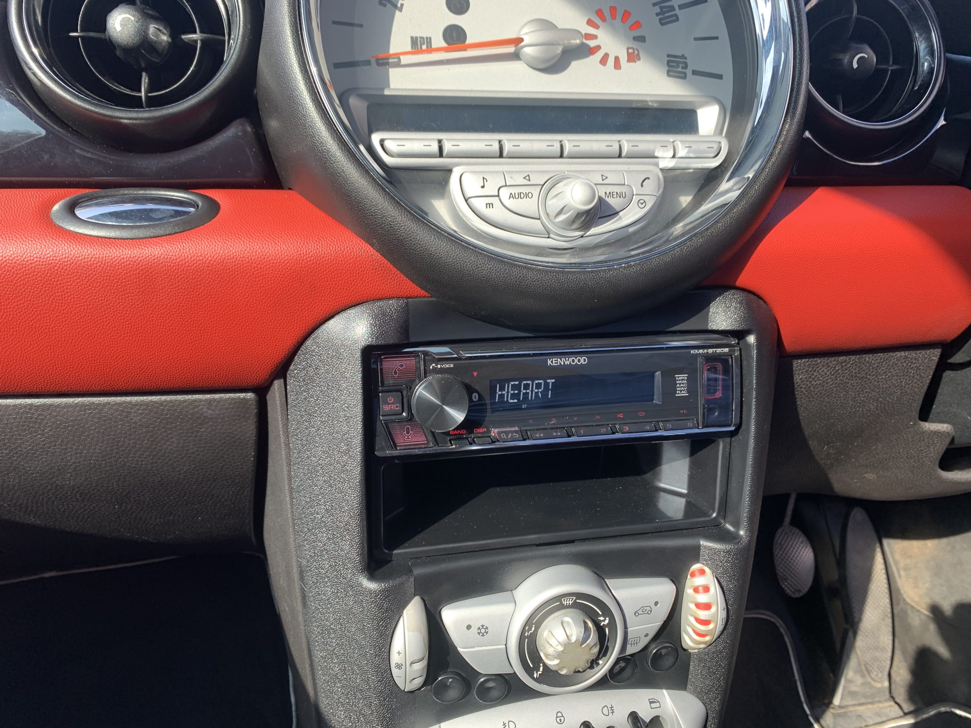

I wouldn't be opposed to a single-DIN HU in place of the CD player, not sure if that's still an option on the 2nd gen.
You can, but it's not as clean of an install due to the integration with the center stack.
Here is one example:
https://www.johnkleisaudio.co.uk/env...headunit-2008/

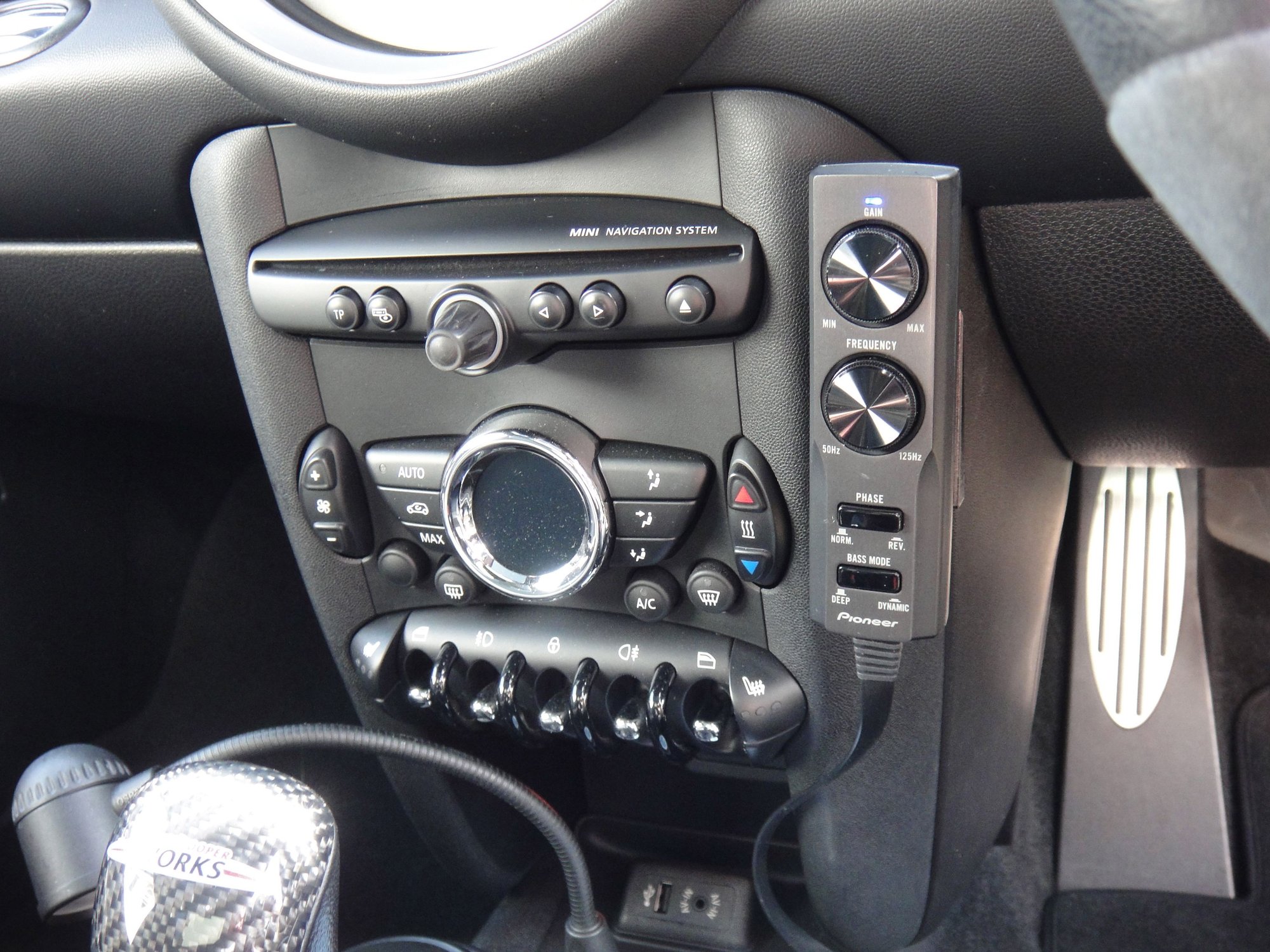

I'm stuffed, as I can't replace my unit. I have the Harman Kardon system fitted & Sat Nav.
From what I've read, I'm going to have to add a DSP.
Old Dec 27, 2024 | 08:42 AM
spikeyadrian's Avatar
spikeyadrian
Joined: Jan 2010
Posts: 125
Likes: 17
From: United Kingdom.
Oh, I forgot to mention. I did fit the Pioneer TS - WX70DA active sub with controller to my H/K system.
Really, and I do mean really, improves the sound. It's a fantastic sub and fits perfectly in the boot!
