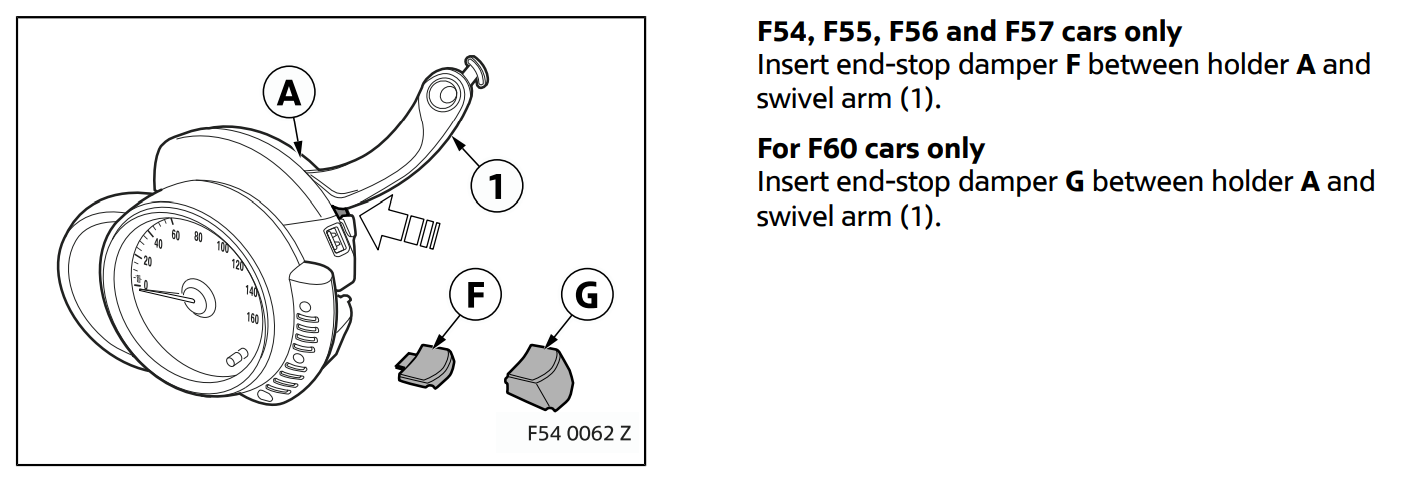

Picked up a Mini Click & Drive unit brand new, and it included two rubber parts (that look like feet to me) in a Ziploc bag that are not in the parts list on the 2013/14-vintage install sheet floating around the Internet in PDF format.
The unit itself did not come with install instructions in the box, so no luck there.
Anybody out there who has installed one of these recognize these parts? Any know what they are for / where they go? Pics below.

At long last, found the answer, in March 2024 -- don't ask what it took to dig this up, lol. And it is NOT in those 2013-vintage instructions. See next post...

Found it! In March 2024

And now I know why the Click and Drive I installed in my F57 would constantly vibrate and make a rattling type noise. Because there were no instructions and I didn’t know what to do with those rubber pieces! I’ve moved on from the Click and Drive anyway, but good to know!

I know right??? I spent a good part of yesterday trying to figure out where I put those rubber pieces, they're around here awaiting attention somewhere
