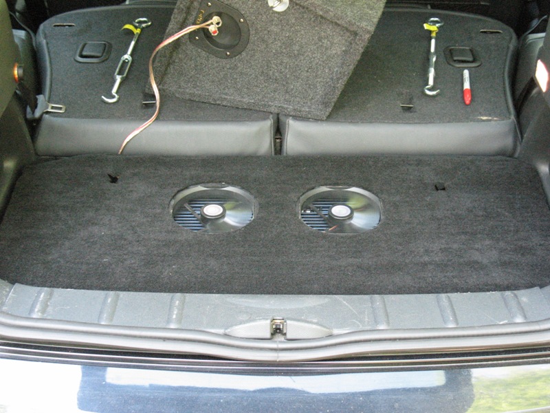

Install......

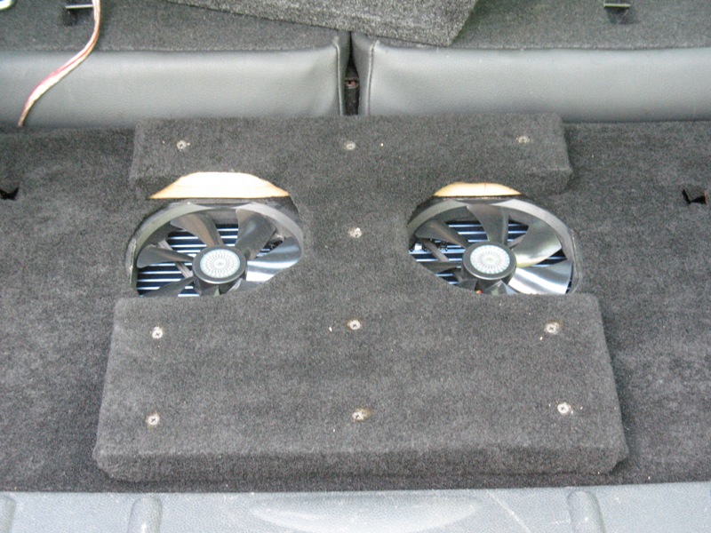

Here are some of the temporarily installed pics....... ongoing project..... it's pretty dirty right now.... will clean it all up before MOTD next week! ROCK! The "false floor" cover that the sub is setting on used to cover everything completely across so you couldn't see anything and I left the gaps around all sides for ventilation..... ummmm, amp still overheated. So this was a temporary fix to keep the amp cooler. Heading out this weekend to pick up some PC case fans (one sucking, one blowing... that's what she said!) to mount on each side of the sub for now for ventilation..... then cover with carpet for the trip to MOTD... did I mention MOTD? I'm so excited! A week of over 500 MINIs....... JAM!
P.S. How do you like my "turnbuckle" solution for the box mount? Not permanent, but you're not moving it!

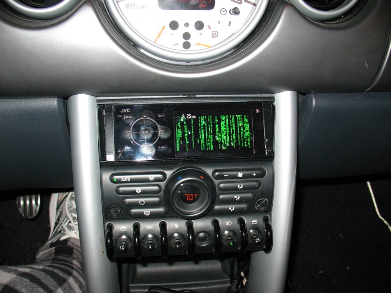

Head unit installed......
Here is the JVC in the dash... sorry for the smudges..... you can't access the menus for adjustment with the remote (sub, crossover, EQ, etc..), and its a touchscreen..... I was playing with it and snapped some shots without thinking about cleaning it first, duh.

No overheating!
After the fan mod and the trip to and from MOTD..... never overheated once
