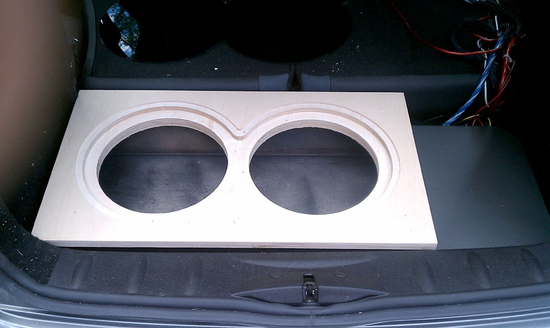

redoing my trunk for a pair of Dayton10's...
and believe it or not this will actually use less space than my single 12 did.
I just got tired of having a 1 cuft box in the boot...just too big.
So this box will be .65 total, and will house a pair of Dayton low-profile subs and if you look to the right you will see the shelf that will hold my arc audio amp is lower than the speakers so while it will be slightly higher than the Urban mini box....it will finish the same once i find some 1/8" mesh aluminum to cut out the grate that i recessed today on my CNC router. More pictures to come once i get everything tidied up. Pardon the mess in the mean time

extremely early opinion here....I just hooked them up...and they are not broken in yet...and i am having some trouble getting them sealed as is to bare wood. I have cut the hole extremely close to the opening size using a CNC router..and there is a rubber gasket glues to the speaker, but it is open around the screw holes and i am definitely leaking air...but i will fix that.

EDIT: found the leak...not the speaker afterall....i had a screw hole in my baffle that once i plugged stop the gushing air...sorry...operator error. :-)
