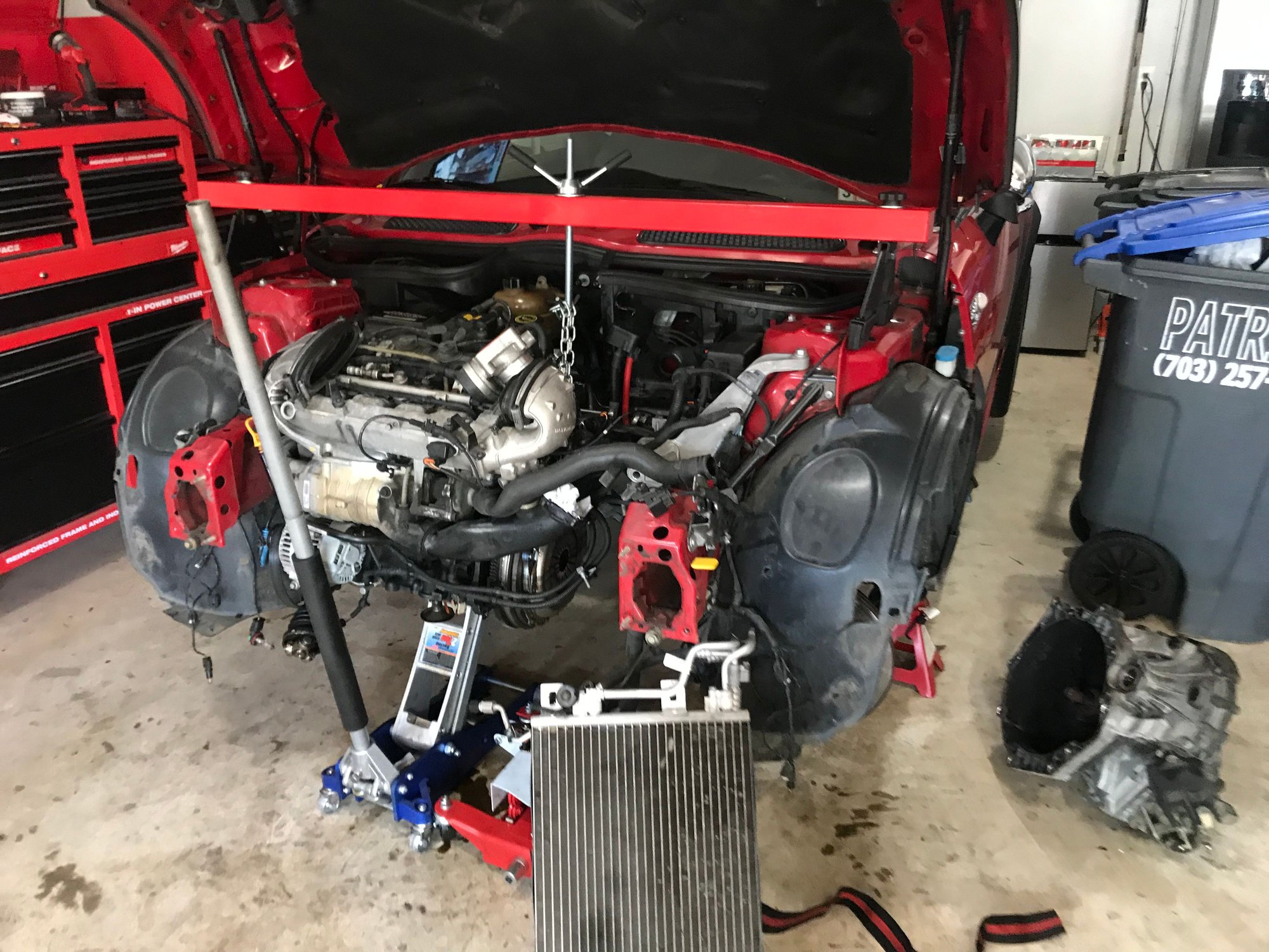

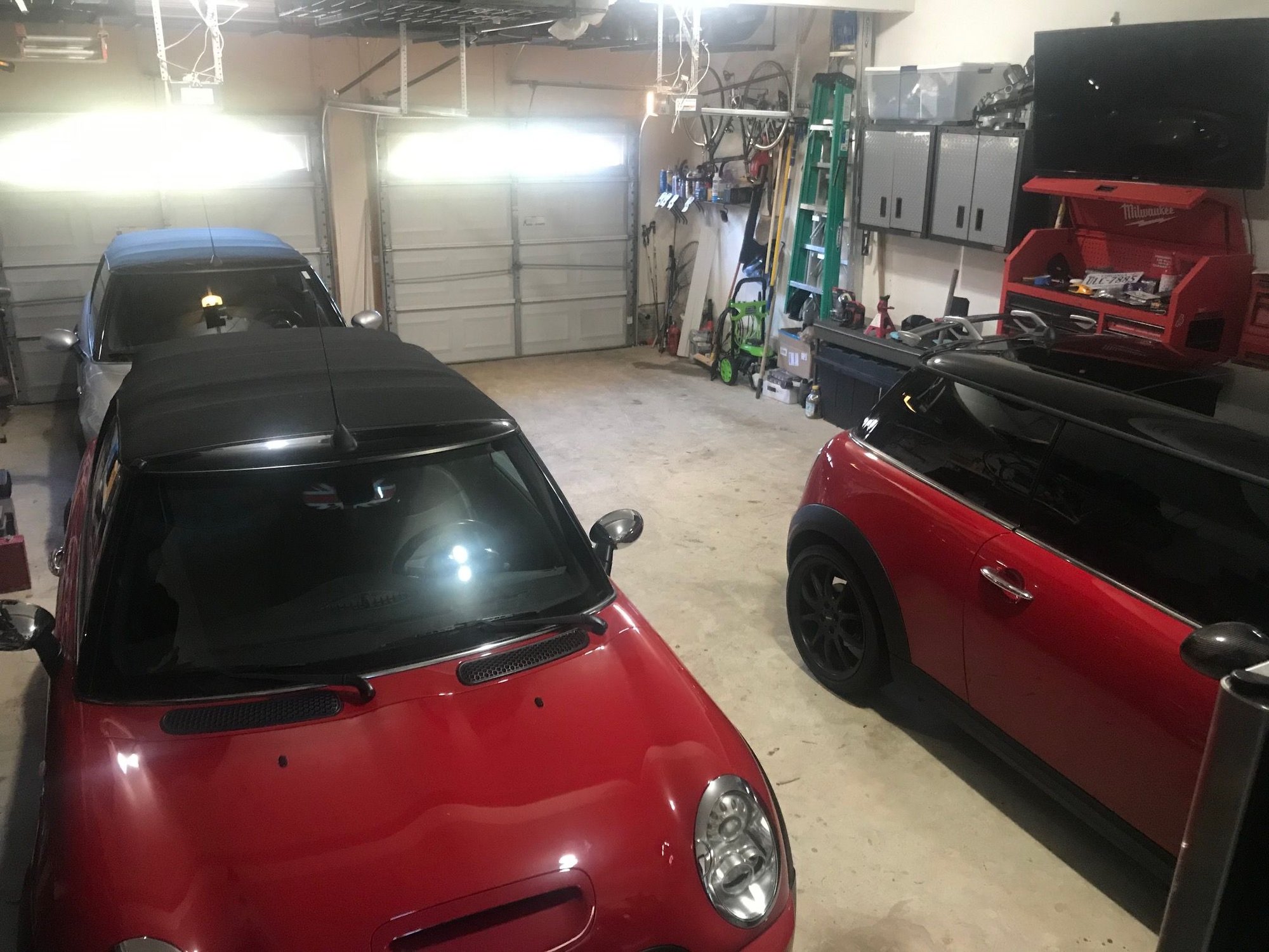

Thank you Rhi and Tom! You guys are my favorite TN residents! I made it home ok. Car has a new home in Northern Va in Ashburn. I'm going to attempt the clutch, rear seal, inner ball joints, control arm bushings, struts in the next 1-2 months and clean up the oil leaks. (position sensor and oil pan gasket) Ive never done a clutch before but I'm watching lots of ModMini videos and I have the tools, space and I don't need the car on the road for a daily. (As this is my third) I could use a contact when I get in a real jam but I think I can do the whole job. (Anyone from DC Metro Minis reading this?)
I dare say I bought it because it is a Gen 1, ragtop, and its a JCW. Its so CRAPTASTIC! I Love the boost and the pops and gurgle! Its so fun! I hope to get it in shape for the summer and maybe do the MTTS from Frederick to Asheville.
My wife hates me cause I spend too much time in the garage. My kids hate me because I bought another stick. Tough love! They will learn soon enough.
My 2 car (or 4 mini) garage will hold 1 more mini so you never know!
Ill be selling the R56 on CL soon. Its an 08,Garage queen, JCW engine tune/exhaust/intake/big brake only 40K miles and it pulls better than the Gen1 JCW. 15 lbs of boost. (but it gets no attention as it doesnt pop and gurgle) Note: If I find a sidewalk JCW R52 , I might just pull the trigger.
Last edited by jschroter@yahoo.com; Mar 4, 2020 at 03:50 AM. Reason: Added Pictures

@BoostedBlueToyotas and anyone else who would like to chime in:
Im making slow progress and you have me thinking about changing the WaterPump and doing the Supercharger service since I have everything apart. Did you replace any seals for the Supercharger? Or just the two Water Pump seals? Throttle body seal? Green gasket for SC?
Ive got a lot going on here so I should probably just focus on getting the clutch back in. I messed up putting in the main seal as I put in in too far I think . (not flush) so I ve ordered another one (This time genuine Mini) and ill try again. I also ordered the transmission seal. (Modmini doesn't change his though when he does his clutch jobs) Pelican recommends it though. Im sending the first clutch back (Valeo setup with single mass flywheel) as it arrived with a damaged throw out bearing (broken plastic holder). It was also missing fasteners. (I admit, I shouldn't have bought a Amazon warehouse deal clutch for $225) At this rate, its going to take me a couple of more weeks. I also ordered a 10 pcs Blue silicone cooling hose setup and the plastic bits. I didn't like the clamps it came with so I ordered a bunch of spring clamps from McMaster-Carr. I also ordered a new but inexpensive power steering pump (Bosch) and the hoses. Heck, I ordered a new starter as Im guessing what is on the car is the original. Oh yeah, I removed the oil filter and changed the gasket as it seemed oil was leaking from that too. I didn't change the o rings for the oil cooler though. Im thinking about going back and doing those. Whats left? Should I read up on changing the crankshaft pulley? I think Rhi and Tom changed the alternator but im not positive. This car is getting some sweet preventive maintenance! Inner ball joints and power flex bushings are installed now...But, its one step forward and two steps back. I wish Id just focus on the clutch! Oh...but while im in there I might as well change the thermostat and oil pan gasket...does this happen to anyone else?
